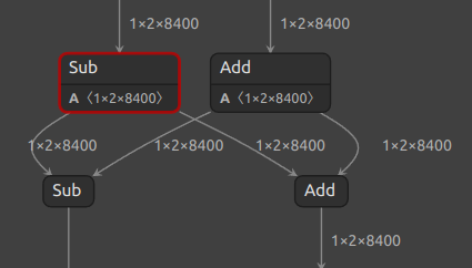

And here is an image of the relevant section. There are two Add and Sub operations; the ones in question are the upper Add and Sub.
I believe that when performing Sub and Add between tensors of shape (1, 2, 8400), the output should also be (1, 2, 8400).
However, Hailo seems to indicate that the output must be (2, 1, 8400).
Is my understanding correct? If so, would forcing the Sub and Add output shape to (2, 1, 8400) by editing the ONNX make it work without issues?
Thank you for reading.
Hi @Park_Hanyu
The postprocessing layers need to be excluded from the onnx file for compiling segmentation models successfully. You can look at the alls files in Hailo model zoo for details. Alternatively, you can use DeGirum’s cloud compiler to compile such models: Early Access to DeGirum Cloud Compiler
