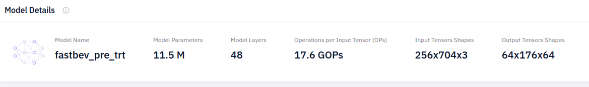

But when i parse this onnx, parser result give me input shape [256,704,3]

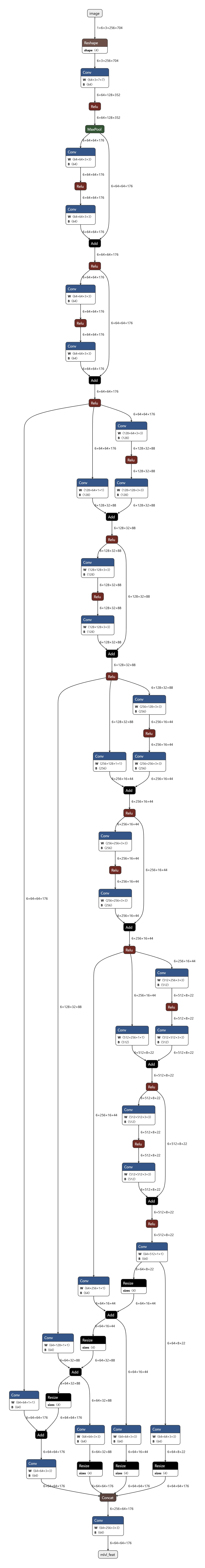

ONNX Graph
Hailo Profiler Result
