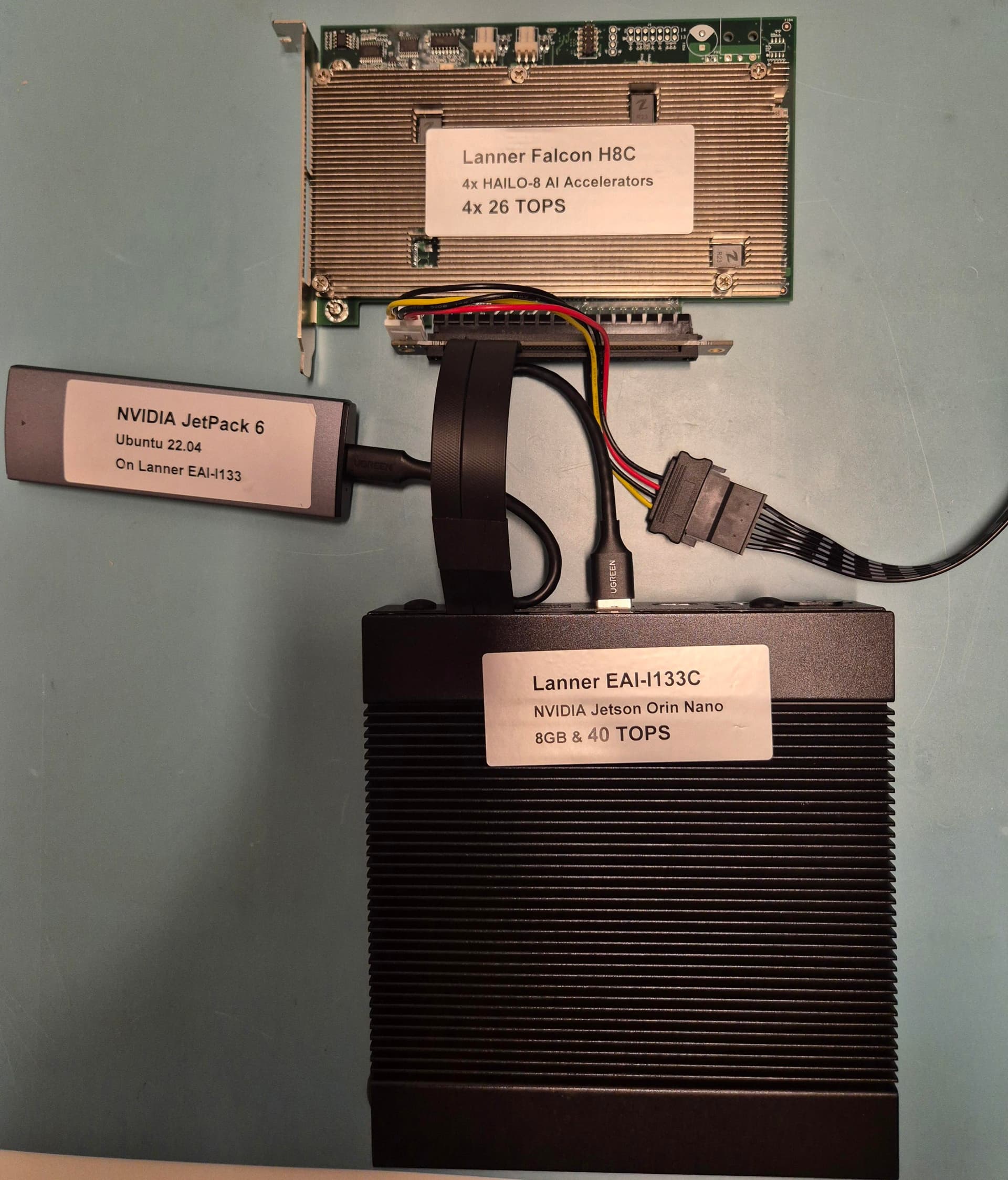

I share here with the community how I successfully ran multiple inferencing pipeline on multiple Hailo-8 chips on an NVIDIA Jetson Orin Nano.
With an external power supply, you can have an ordinary Orin Nano riding up to 144 TOPS. I used a Jetson Orin Nano 8GB (40 TOPS before going “super”) from Lanner. On this device, there is a PCIe x4 lane. As a comparison, Raspberry Pi 5 has only one 1 PCIe x1 lane. (Imagine at the toll station, 4 lanes vs 1 lane, 100 cars coming, which config moves faster?) With a M.2 to PCIe converter, I connected to Orin a 4-Hailo chip card Falcon H8C.

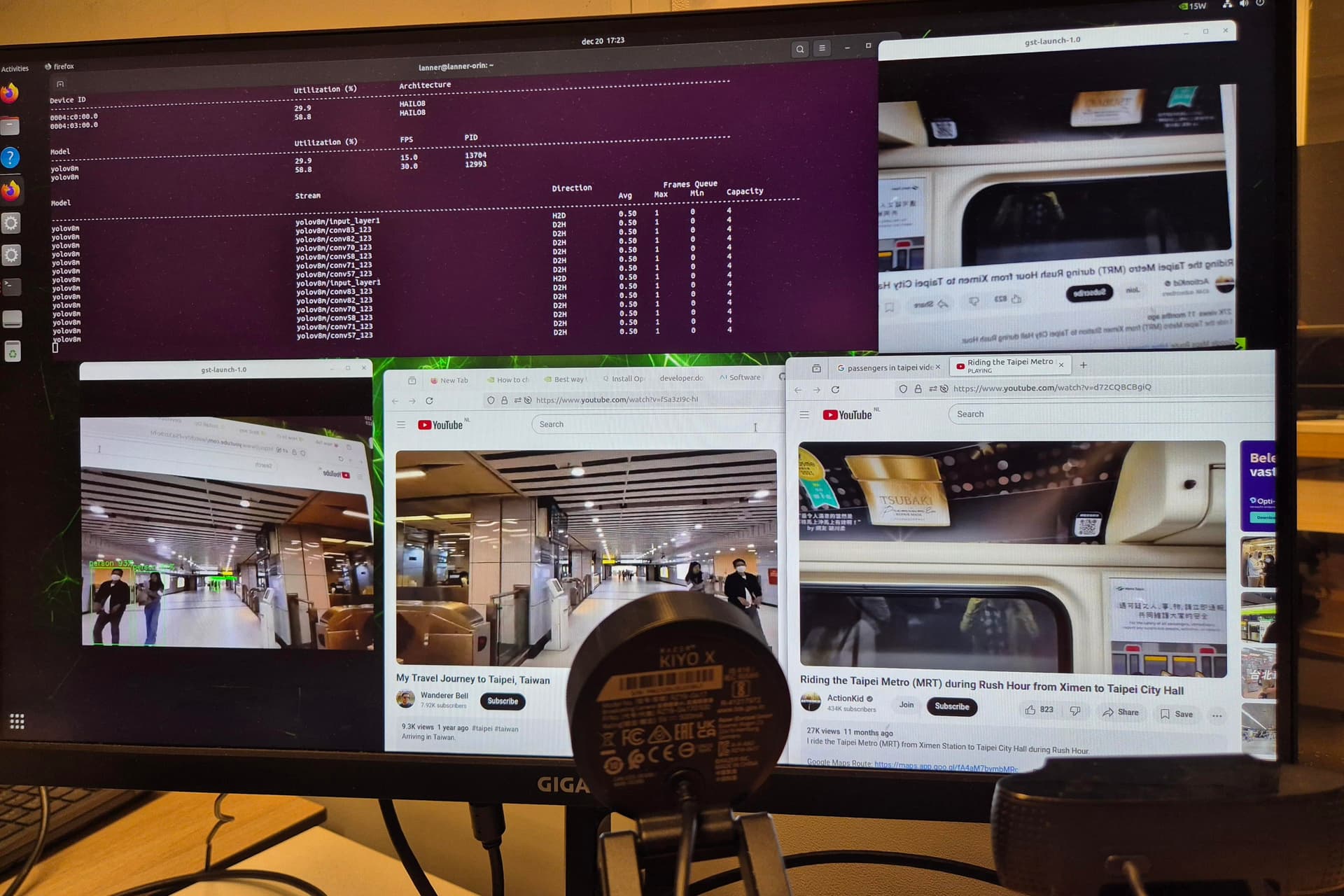

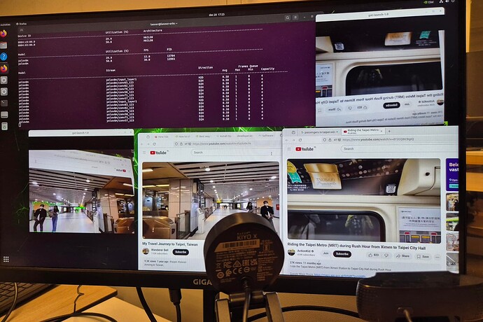

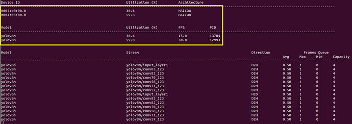

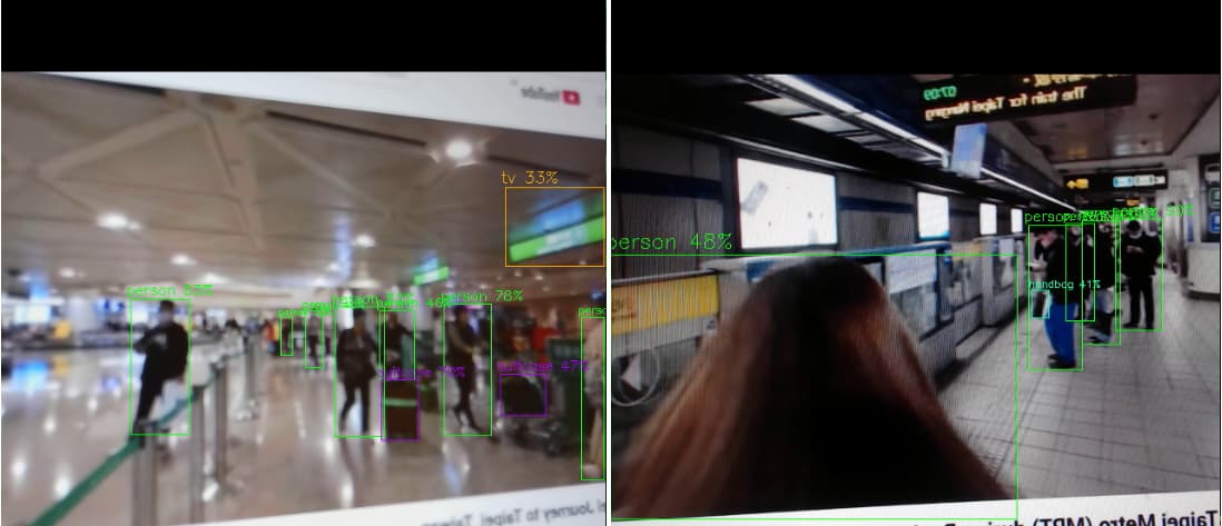

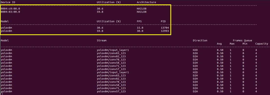

I only had 2 USB cameras on my desk and I found on Youtube some videos of metro in Taipei. You can see that 2 YOLOv8 models - used in the inferencing pipeline for object detection - are running on 2 separate Hailo chips.
Here the GPU on Jetson Orin is largely spared, ready for other tasks.
