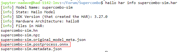

Been able to parse (after simplifier) up untli there: hailo parser onnx supercombo-sim.onnx --end-node-names Conv_200 --start-node-names Conv_0
Yes, I am using the supercombo.onnx model.
As you pointed out, I was able to compile the model and perform inference up to a certain point. However, if possible, I would prefer to run the entire supercombo.onnx model, including the final layers, on Hailo8.
I was able to specify an intermediate point in the ML model using --end-node-names and perform inference up to that point with Hailo. For the remaining part, I currently use a tool I have to edit the ONNX and create an ONNX file that performs inference only from the point after --end-node-names.
However, I believe that the Hailo dataflow compiler tool might have a feature to offload the remaining part to the CPU. When performing inference with Hailo up to an intermediate point in the ML model, how is the remaining part expected to be inferred?
