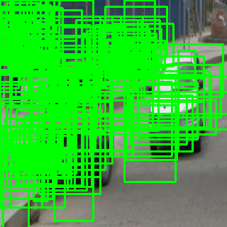

Converted MobileNetV3-SSDLite pretrained on the COCO dataset provided by torchvision to HEF.
However, we encountered a problem that the detection results were not good on real images.
NMS configuration and detection results are attached.

This results in a detection score of 0.99 or higher.
Your help would be appreciated.
