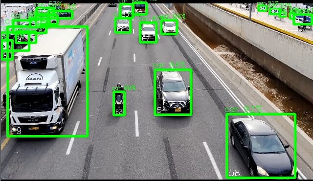

Hi @omria ,
I have tested the LPR application with another Israel road traffic from Youtube, and the application managed to detect and printed out some of the car plates.
As you can see from the image above, although there is some car plates got recognised but most of them are being ignored. May I know why it is acting like this? Is it because of the video resolution is not clear enough, or the camera angle is not correct?
Besides that, I would also like to know if I would want to run the application for other country’s vehicles, do I just need to retrain the LPRNet model, or the tiny_yolov4_license_plates model would be required too?
Other than testing with the video, I also tried to run the application with a web cam (EMeet FHD 1080p C960), however, my input camera framerate and resolution seems to be very low, so the live video is abit laggy and blur. Could you suggest some USB Camera which is good enough for the real application?
