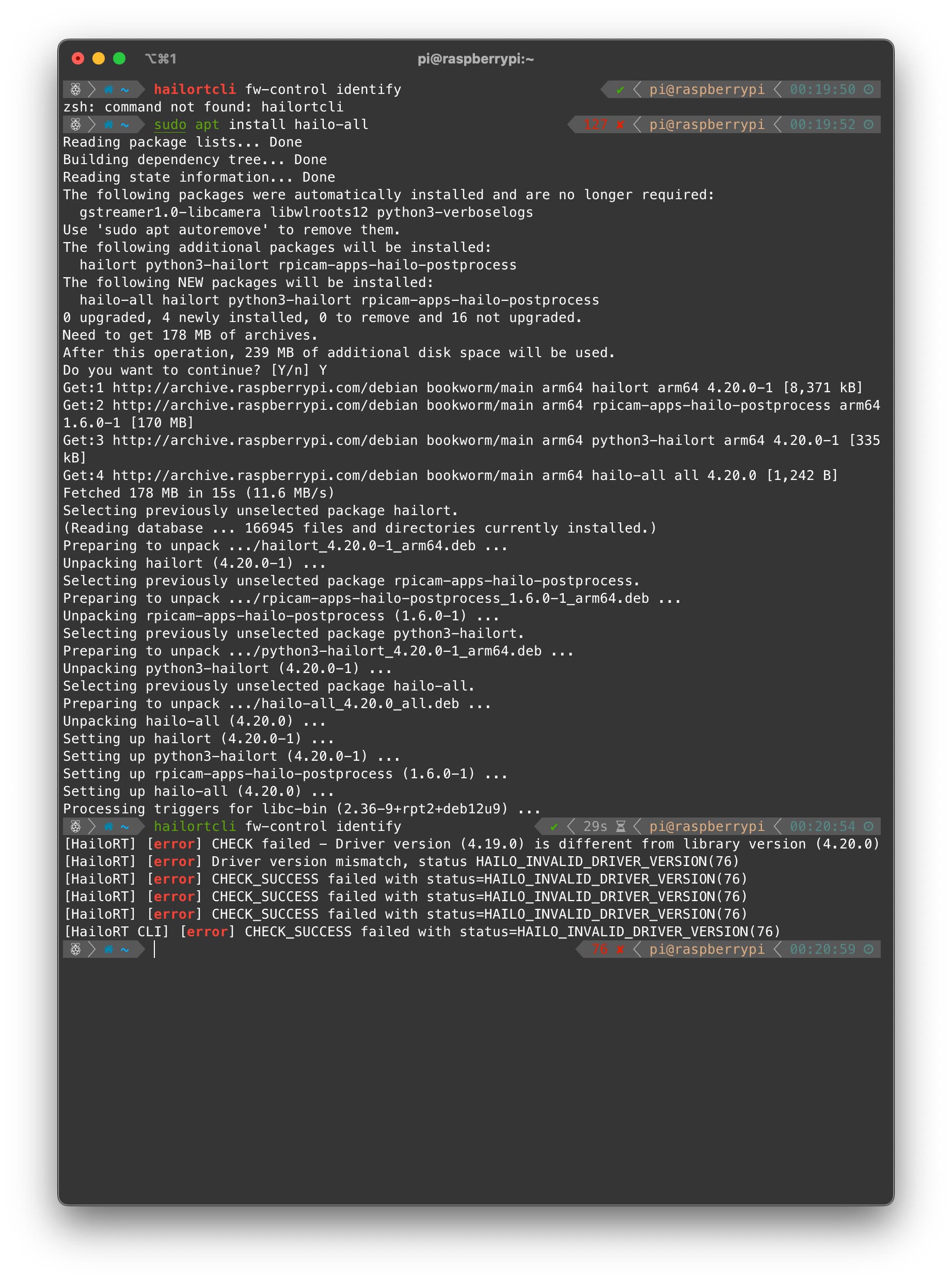

i have the same issue here:
Guessing the script is updating?
found the same issue happened when 4.18 → 4.19
I had this issue and the solution was to run
sudo apt update
sudo apt full-upgrade
sudo apt install hailo-all
Same response as in this thread
