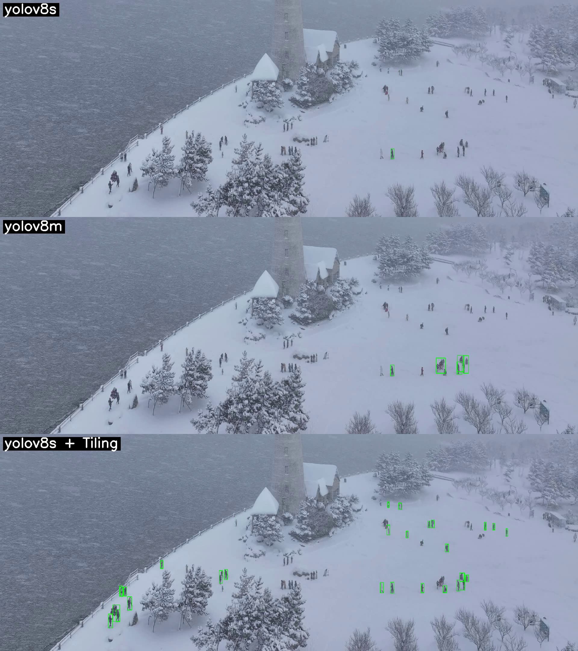

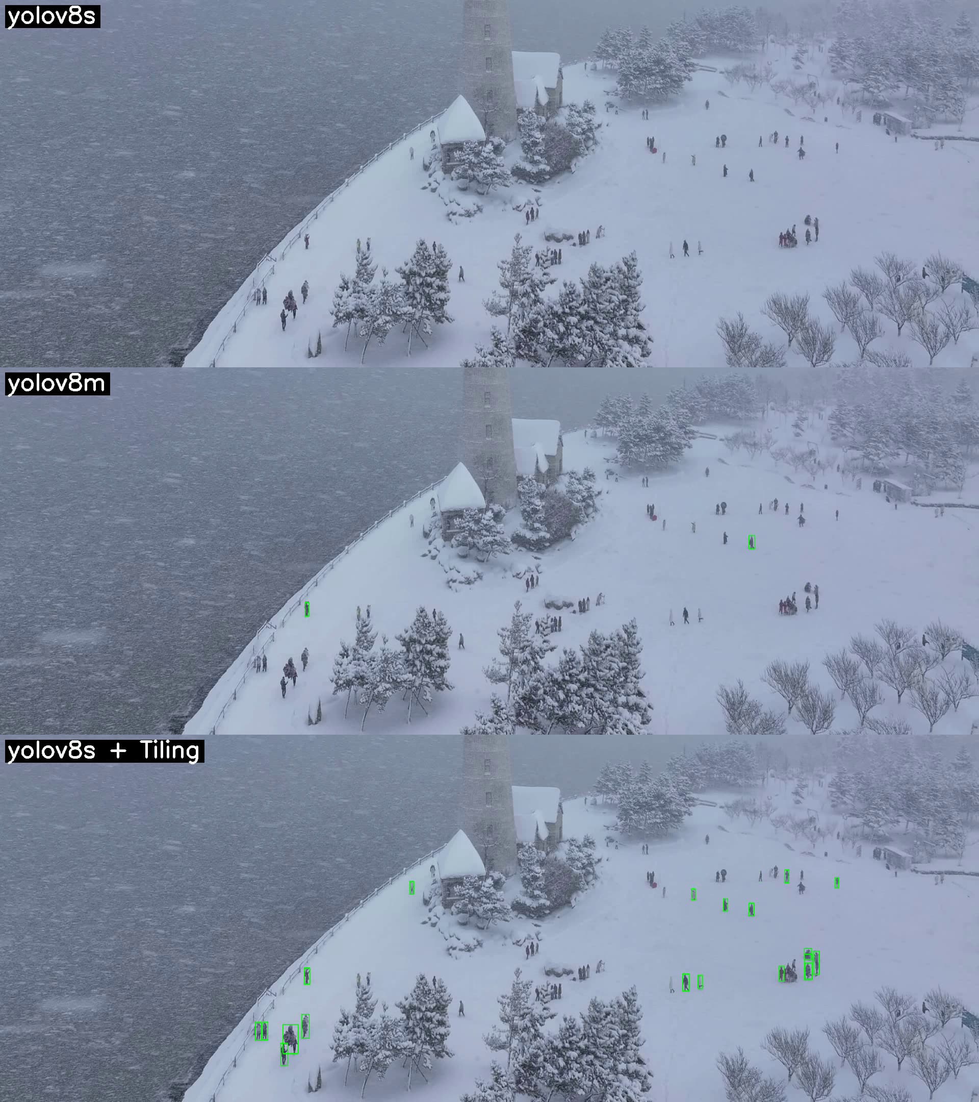

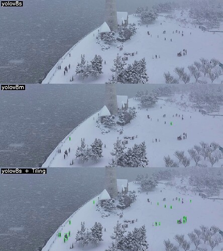

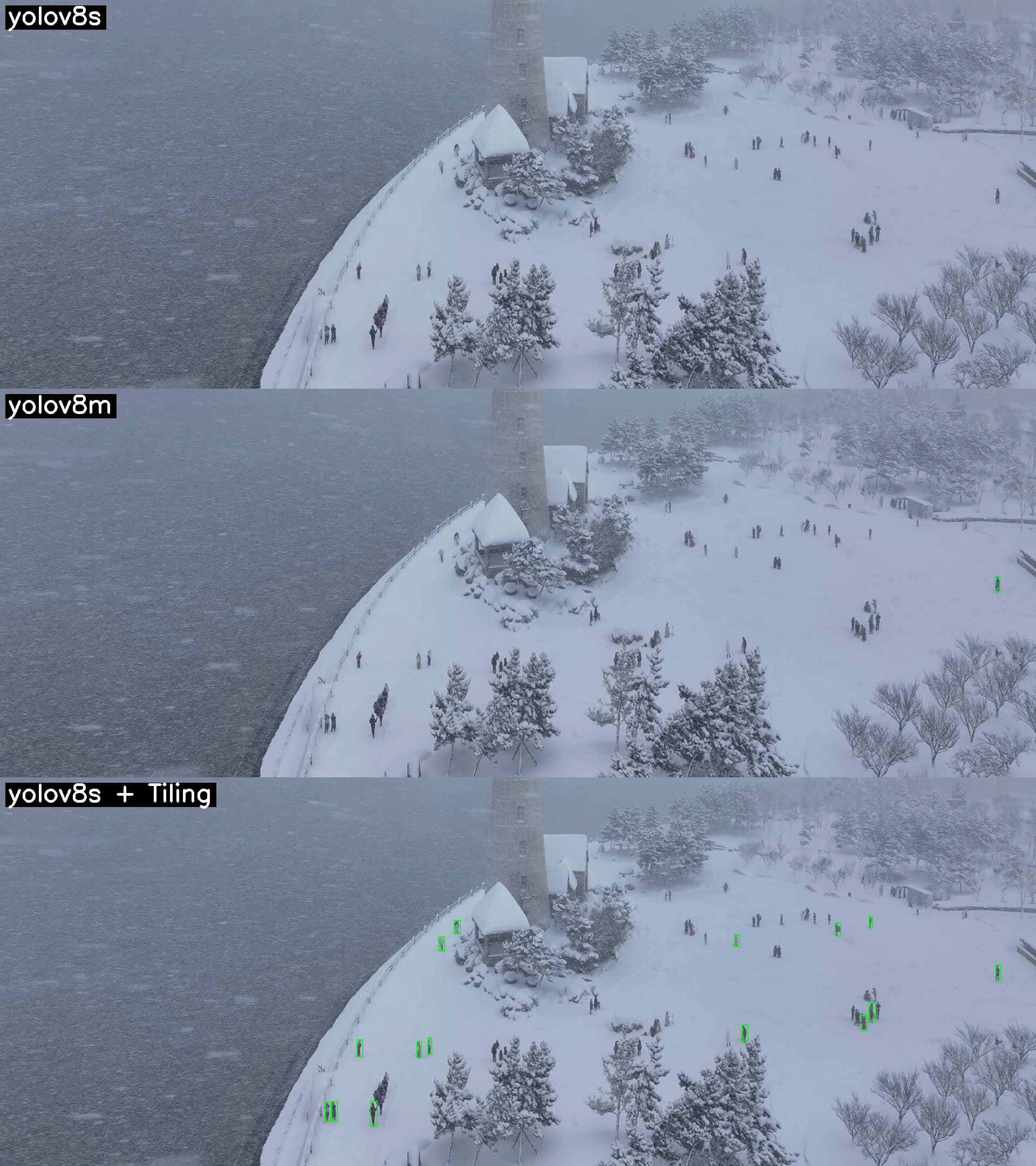

Detection Results
The following results compare detection performance using the same confidence threshold on:
The results clearly show that tiling dramatically improves the detection of small objects, even when using the lighter YOLOv8s model. Many targets missed in the full-frame tests were successfully detected in the tiled approach.
