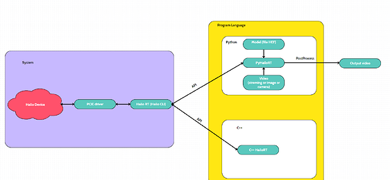

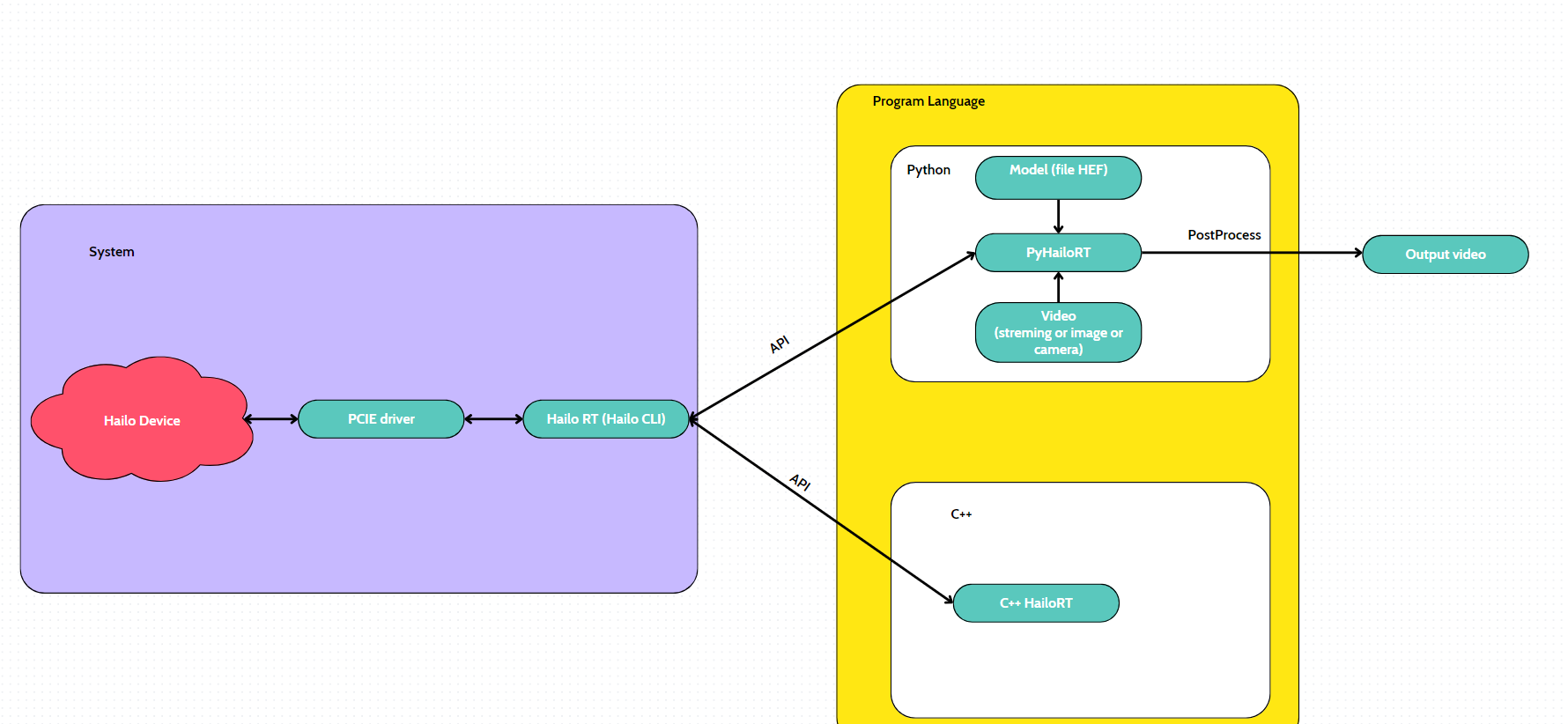

I followed this guidance (https://github.com/hailo-ai/Hailo-Application-Code-Examples), and it is not required that hailortcli and tapas be installed. I thought tappas were just examples. I will install hailocli and tappas and try again. I drew a figure to represent my thoughts about the hailo workflow. I don’t know whether it is correct. Can you check it for me? Thank you!

Regarding your scheme is not 100% correct. It is more like this:
The Python APIs (bindings)-> HailoRT → HailoRT PCIe Driver.
The error you are seeing may be due to a missing HailoRT library, or a misalignment in the PyHailoRT/HailORT versions. How did you perform the installation?
If you used the .whl file, please be aware that it just installs the Python bindings, and not the HailoRT library.
Depending on your system, the HailoRT library can be installed in different ways (.deb file, sources, …). Please refer to the HailoRT User Guide for the detailed procedure.

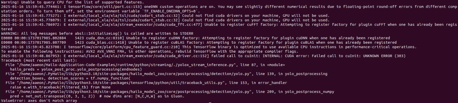

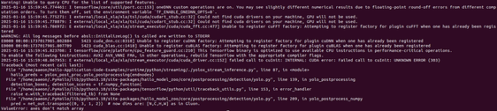

I do every thing from start, i install hailort(deb) → hailo PCIE(deb) → create a venv → hailort(.whl)-> model zoo ->dependency like numpy(1.x version) ->opencv → run example code “yolox_stream_inference.py” get an error (need tensoflow)-> install tensorflow ->run example code again and get this error
Please help me!!! thank you.
