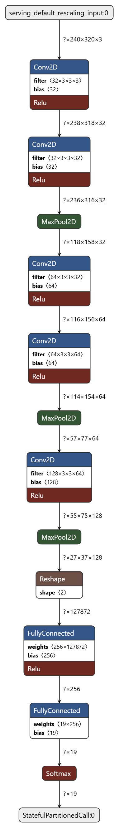

here is some error occurred

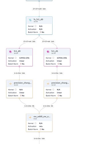

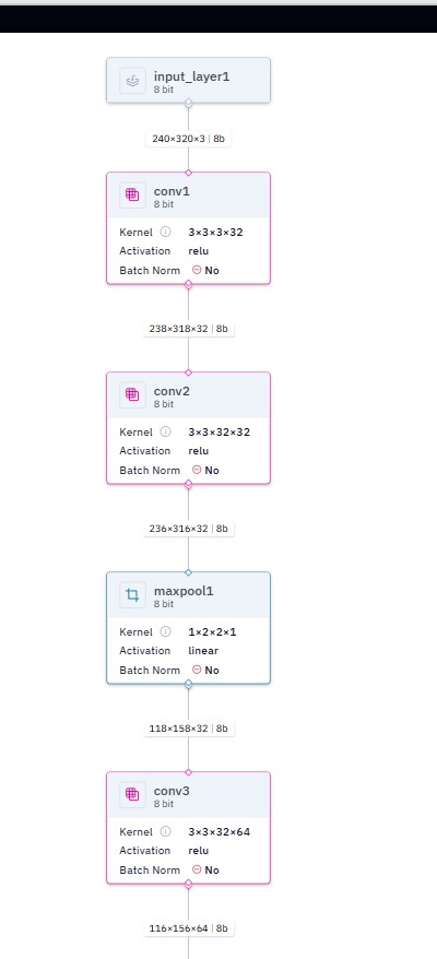

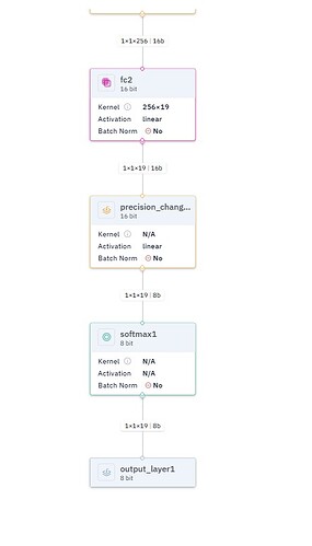

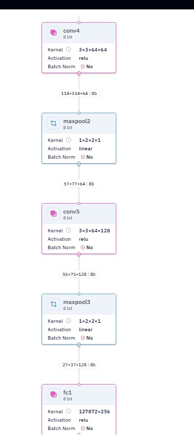

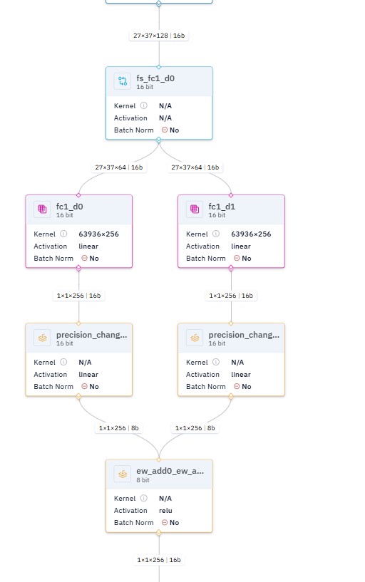

Hello, I share you some screenshots please check it.
hello sir please reply to this
Hey @Ketul_Patel!
Looking at your screenshots, here’s the issue:
  • fc1_d0: Shape (1, 128) - flat/linear tensor format
  • fc1_d1: Shape (1, 16, 8) - 3D tensor format (likely NHCW or NHWC)
You’re trying to do an element-wise addition between these two, but they have completely different shapes and memory layouts. The Hailo compiler can’t automatically figure out how to convert between them for internal nodes (it only does this automatically at model inputs).
How To Fix
You need to reshape and transpose fc1_d1 to match fc1_d0’s flat format before the addition.
Updated Model Script
Here’s your fixed .alls script with the necessary changes:

Graph Connection Update
Important: In your model graph, make sure the element-wise Add operation connects to:
  • fc1_d0 (unchanged)
  • fc1_d1_reshaped (NOT the original fc1_d1)
So it should look like: Add(fc1_d0, fc1_d1_reshaped)
Why This Works
  • Transpose first: This handles any row/column memory order issues between the layouts
  • Reshape second: This flattens the 3D tensor (1, 16, 8) into the required (1, 128) shape
  • Compiler restriction: Hailo only inserts automatic format conversions at model entry points, not between internal nodes - that’s why we need to do this explicitly

thank youfor your support i will check this
