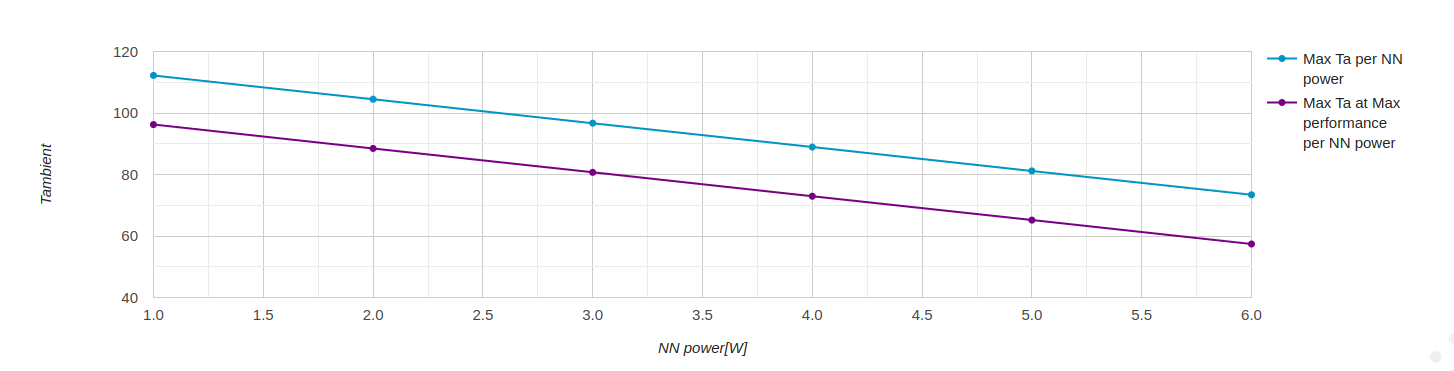

The thermal test is designed to generate a report containing the necessary data, including a graph that illustrates the maximum ambient temperature at which you can operate a neural network with a specific power.
