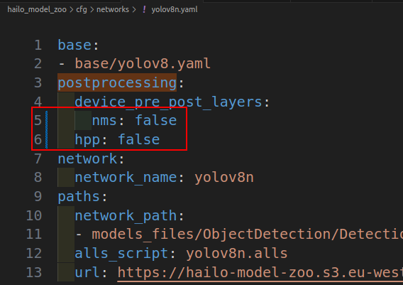

I made two attempts:
Modify hpp and nms in yolov8n.yaml to false, but unfortunately it seems to have no effect.
Directly delete nms_postprocess in yolov8n.alls, which seems to work. But I don’t know if it will cause other serious effects.
