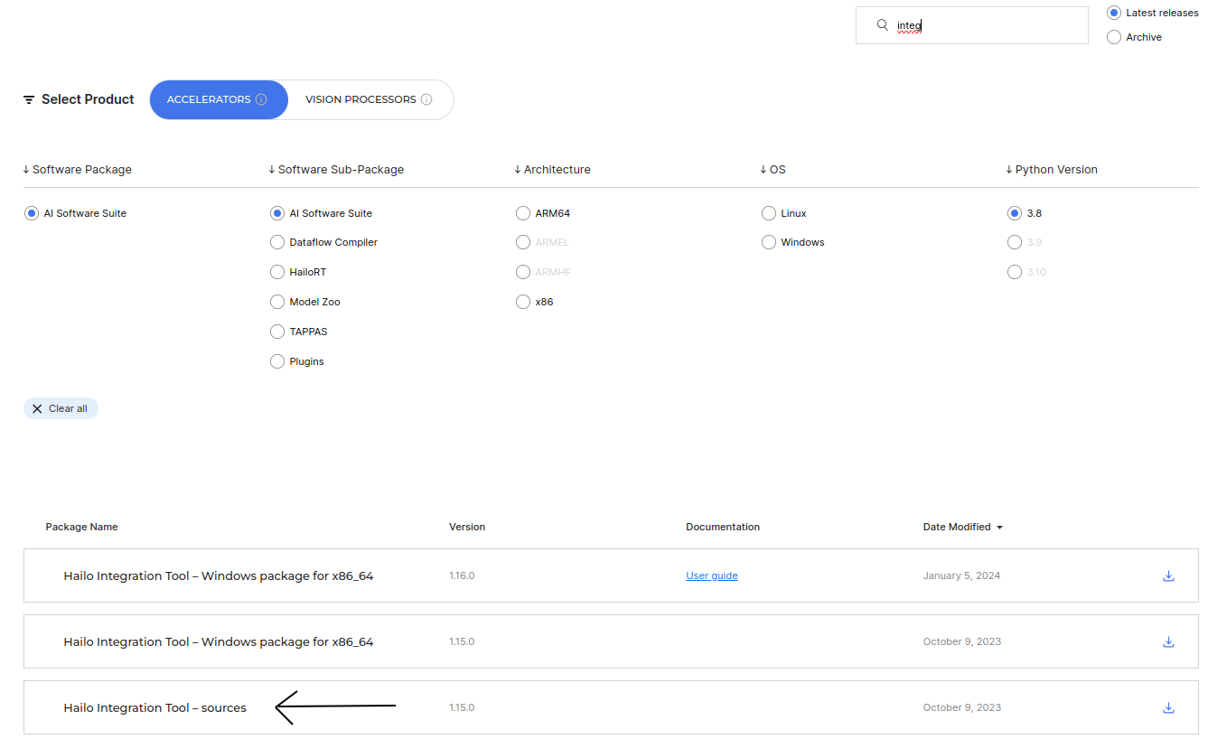

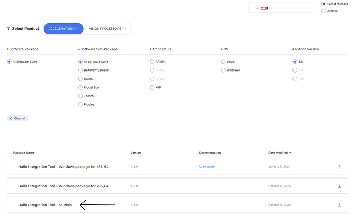

  1. Download the latest source package of hailo integration tool from the dev zone

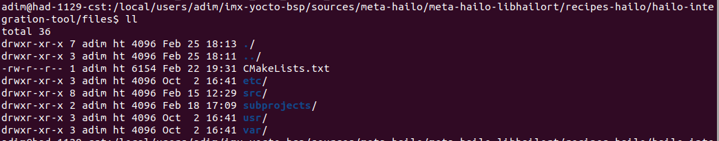

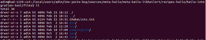

    Create a folder called “hailo-integration-tool” and a folder called “files” within it
  3. Extract the contents of the downloaded zip file into the “files” folder created in previous step
