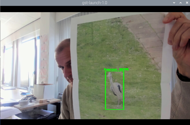

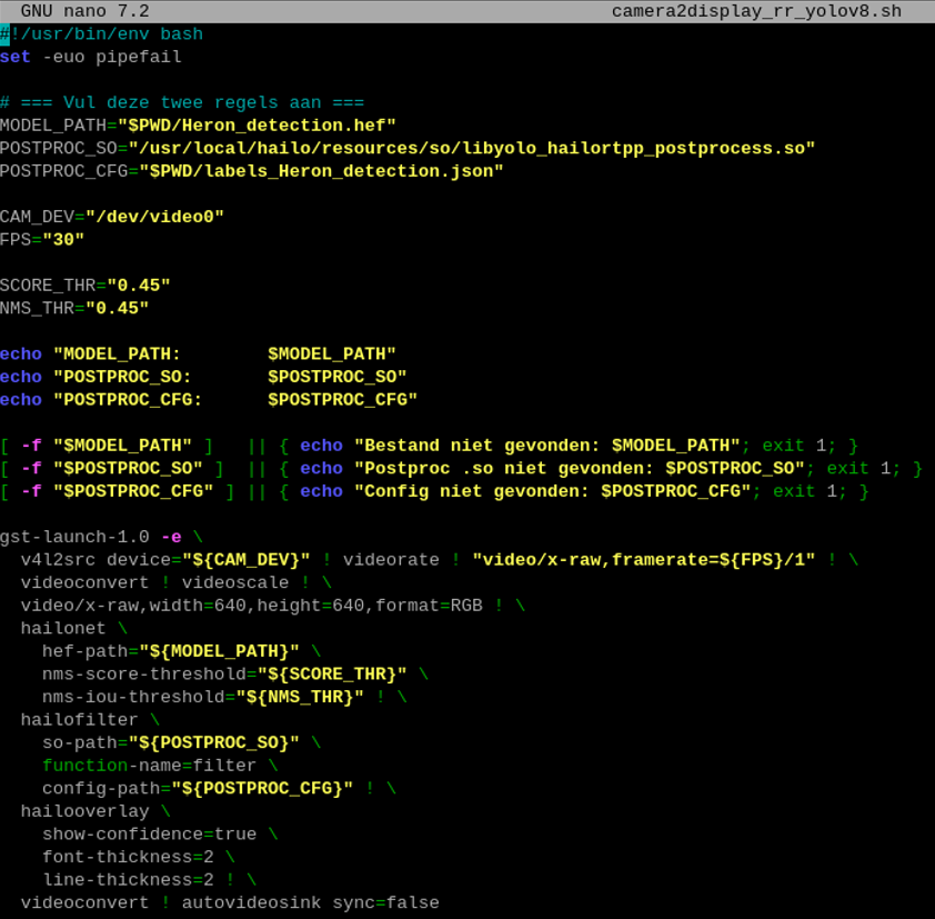

To do an extra check of the model, I tried a small Python script to run my model:
Below the result of the test.
So the model if fine for sure :partying_face: .
