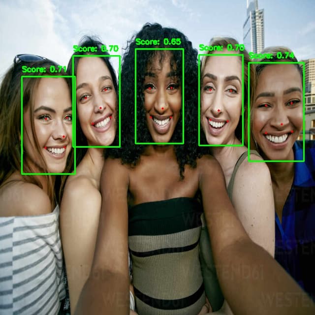

I’ve solved my issue by rescaling the landmark outputs from the network from uint8 → float32 and applying a denormalization.
I’m getting pretty good results, but they aren’t as good as the official insightface using the ONNX file. I was wondering if this is because the model is quantized and therefor lose some accuracy, or if it’s because some other reason.
@omria Do you have any ideas?
You can see here that the results are a few pixels off.
Here is my code

    def _decode_boxes(self, box_detections, anchors):
        x1 = anchors[:, 0] - box_detections[:, 0] * anchors[:, 2]
        y1 = anchors[:, 1] - box_detections[:, 1] * anchors[:, 3]
        x2 = anchors[:, 0] + box_detections[:, 2] * anchors[:, 2]
        y2 = anchors[:, 1] + box_detections[:, 3] * anchors[:, 3]
        return np.stack([x1, y1, x2, y2], axis=-1)
    def main(self, endnodes):
        box_predictions, classes_predictions, landmarks_predictors = self.collect_box_class_predictions(endnodes)
        additional_fields = {}
        detection_scores = classes_predictions
        batch_size, num_proposals = box_predictions.shape[:2]
        tiled_anchor_boxes = np.tile(self._anchors[np.newaxis, :, :], [batch_size, 1, 1])
        tiled_anchors_boxlist = tiled_anchor_boxes.reshape(-1, 4)
        decoded_boxes = self._decode_boxes(box_predictions.reshape(-1, 4), tiled_anchors_boxlist)
        detection_boxes = decoded_boxes.reshape(batch_size, num_proposals, 4)
        decoded_landmarks = self._decode_landmarks(
            landmarks_predictors.reshape(-1, 10), tiled_anchors_boxlist
        decoded_landmarks = decoded_landmarks.reshape(batch_size, num_proposals, 10)
        detection_boxes = np.expand_dims(detection_boxes, axis=2)
        nmsed_boxes, nmsed_scores, nmsed_landmarks = (
            self._batch_multiclass_nms(
                boxes=detection_boxes,
                scores=detection_scores,
                landmarks=decoded_landmarks
        num_detections = nmsed_scores.size
        results = {
            "detection_boxes": nmsed_boxes,
            "detection_scores": nmsed_scores,
            "num_detections": num_detections,
            "face_landmarks": nmsed_landmarks
        return results
    def _batch_multiclass_nms(self, boxes, scores, landmarks):
        assert boxes.shape[0] == 1, "Batch size must be 1"
        batch_boxes = boxes[0, :, 0, :]  # Shape: [num_boxes, 4]
        batch_scores = scores[0, :, 0]  # Shape: [num_boxes]
        batch_landmarks = landmarks[0]  # Shape: [num_boxes, 10]
        # Filter based on score threshold
        score_mask = batch_scores >= self._score_threshold
        filtered_boxes = batch_boxes[score_mask]
        filtered_scores = batch_scores[score_mask]
        filtered_landmarks = batch_landmarks[score_mask]
        # Apply non-max suppression
        keep_indices = non_max_suppression(
            filtered_boxes,
            filtered_scores,
            iou_threshold=self._nms_iou_thresh
        # Apply the keep indices to all our tensors
        nmsed_boxes = filtered_boxes[keep_indices]
        nmsed_scores = filtered_scores[keep_indices]
        nmsed_landmarks = filtered_landmarks[keep_indices]
        # Add batch dimension back
        nmsed_boxes = np.expand_dims(nmsed_boxes, axis=0)
        nmsed_scores = np.expand_dims(nmsed_scores, axis=0)
        nmsed_landmarks = np.expand_dims(nmsed_landmarks, axis=0)
        return nmsed_boxes, nmsed_scores, nmsed_landmarks
if __name__ == "__main__":
    config = {
        "nms_iou_thresh": 0.4,
        "score_threshold": 0.02,
        "anchors": {
            "steps": [8, 16, 32],
            "min_sizes": [
                [16, 32],
                [64, 128],
                [256, 512]
    postprocessor = SCRFDPostProc(
        image_dims=(640, 640),
        nms_iou_thresh=config["nms_iou_thresh"],
        score_threshold=config["score_threshold"],
        anchors=config["anchors"]
