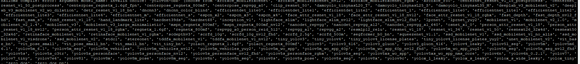

Hailomz no obb model name for compiling to onnx to hef
During Compiling to hef format i find that there is no model argument for yolov8n-obb. How to fix this
You can either wait for an update, or convert only the part of the yolov8-obb model that can operate on hailo to .hef through DFC and coding the pre&post-processing refering the yolov-8 cpp source code.
can get any reference on this particular model conversion
