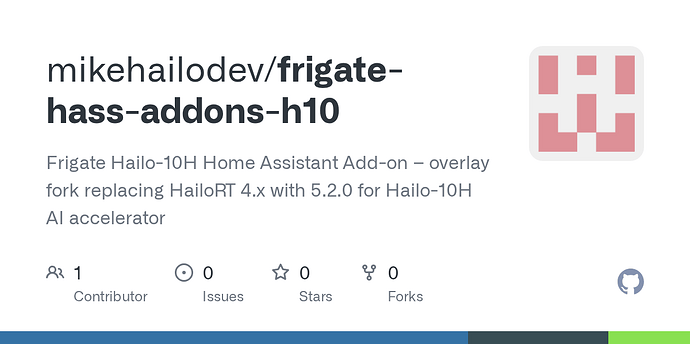

Hailo-10H for Frigate - Hailo-10H runtime integration into Frigate, packaged as a Home Assistant add-on

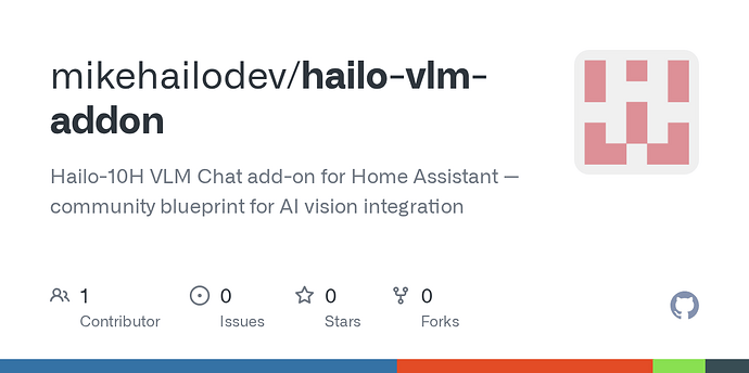

Hailo VLM Chat add-on - Usage example of how to build an app with Hailo runtime that uses the OS driver. Our example is a Vision Language Model chat app that can describe and answer questions about what your cameras see.

Step 2 - Install the Hailo-10H for Frigate Add-on
In Home Assistant, go to Settings → Add-ons → Add-on Store → ⋮ → Repositories and add:
Install “Hailo-10H for Frigate (Full Access)”, disable Protection Mode, and configure your Frigate YAML with the detector set to type: hailo8l (this is intentional - we kept the detector key unchanged). The add-on automatically detects Hailo-10H hardware - no further configuration needed. Please see here a full guide: Hailo + Homeassistant + Frigate. Please note that a custom YOLO model path is required, for example:
model:
  width: 640
  height: 640
  input_tensor: nhwc
  input_pixel_format: rgb
  input_dtype: int
  model_type: yolo-generic
  labelmap_path: /labelmap/coco-80.txt
  path: https://hailo-model-zoo.s3.eu-west-2.amazonaws.com/ModelZoo/Compiled/v5.2.0/hailo10h/yolov8m.hef
Step 3 — Install the Hailo VLM Chat Add-on
Add the repository:
Install “Hailo-10H VLM Chat”, disable Protection Mode, and configure your camera source in the add-on settings. Use an RTSP URL (e.g. rtsp://your-camera-ip:554/stream) or a USB device path (e.g. video0).
Place your VLM HEF model file in media on your HA instance, and you’re ready to go.
For example if you have the SSH add-on in Home Assistant:
scp ~/path-to/Qwen2-VL-2B-Instruct.hef hass_user@hass_url:/tmp
ssh hass_user@hass_url "sudo mv /tmp/Qwen2-VL-2B-Instruct.hef /media/"
