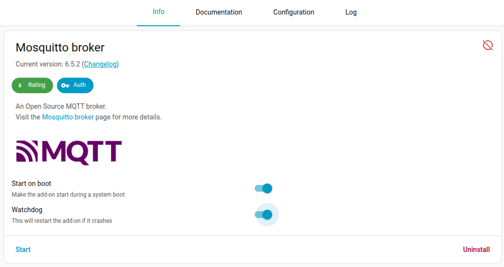

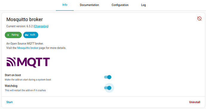

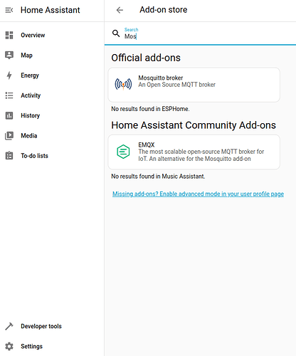

  1. Install the MQTT broker “Add-on”.
Enable Watchdog and “Start”.

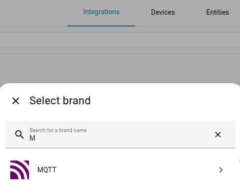

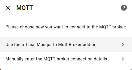

  1. Add MQTT “Integration”: First option (MQTT) and then again the first option (“Use the official…”).

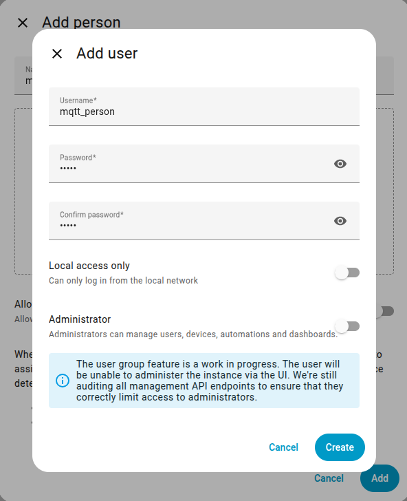

  1. Create MQTT “User”: Settings → People → Add person.

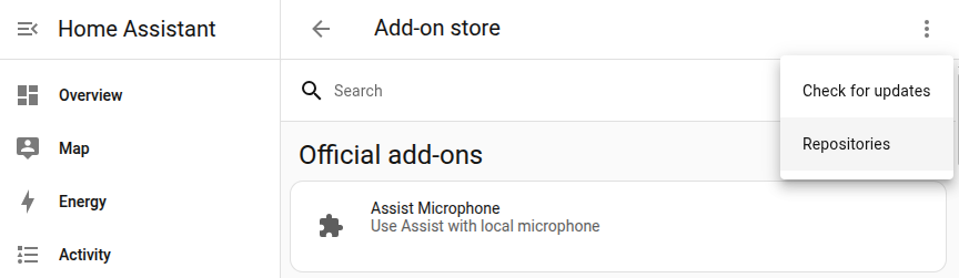

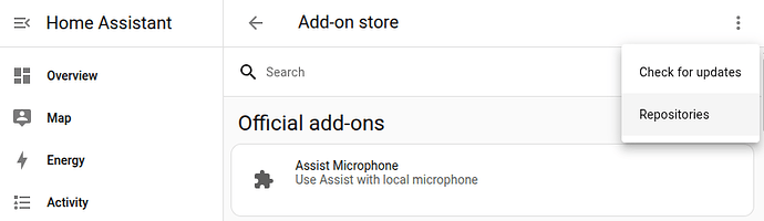

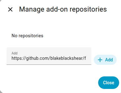

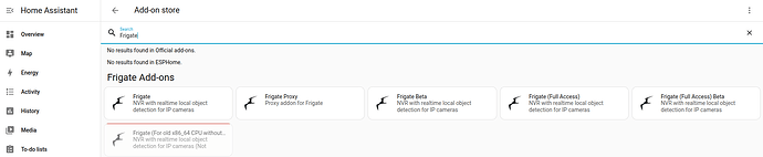

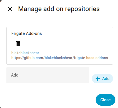

  1. In the “Add-on”'s page select “Add-on store” and then press the 3 dots and select “Repositories”.
Paste the following repository link: GitHub - blakeblackshear/frigate-hass-addons: Frigate hass.io addons

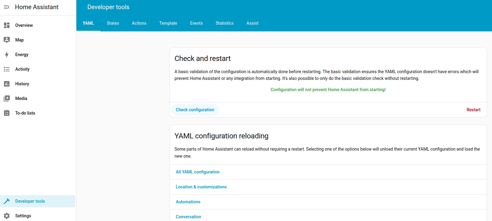

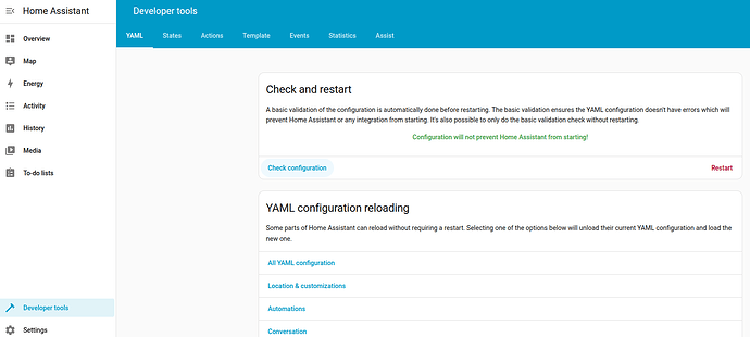

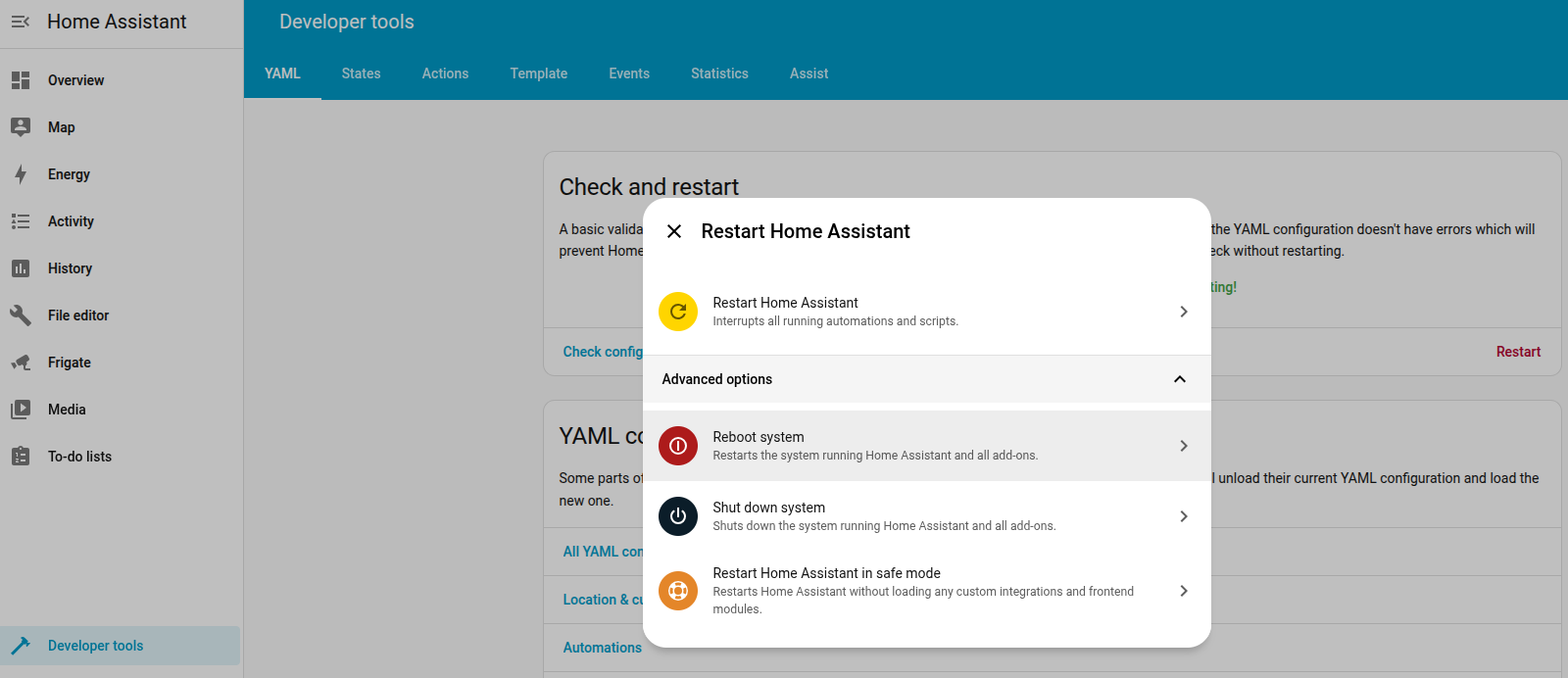

  1. Restart Home assistant: Developer tools → Check and restart → press “Check configuration” and then press “Restart”.

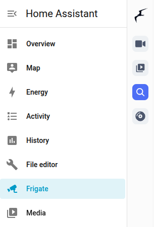

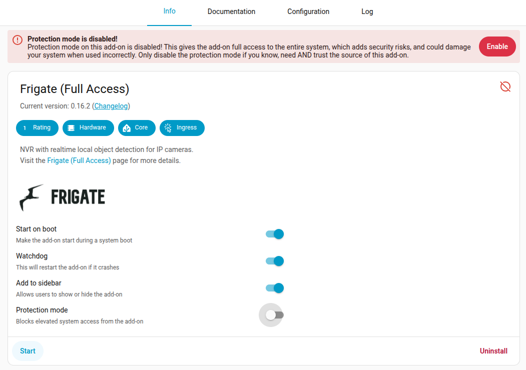

  2. Now the Frigate “Add-on” is available - select the “Full Access” option.
  1. Enable “Watchdog” and disable “Protection mode” and then “Start”.

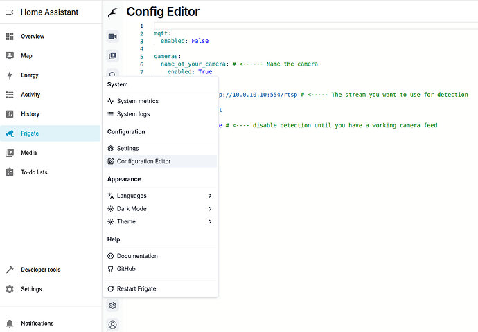

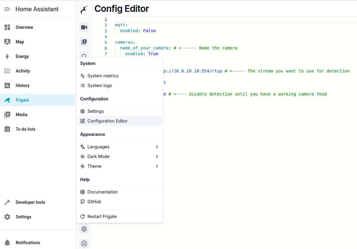

  1. Go to Frigate and in Settings select “Configuration Editor”.
  1. Example configuration - Edit based on your details the lines with TODO:

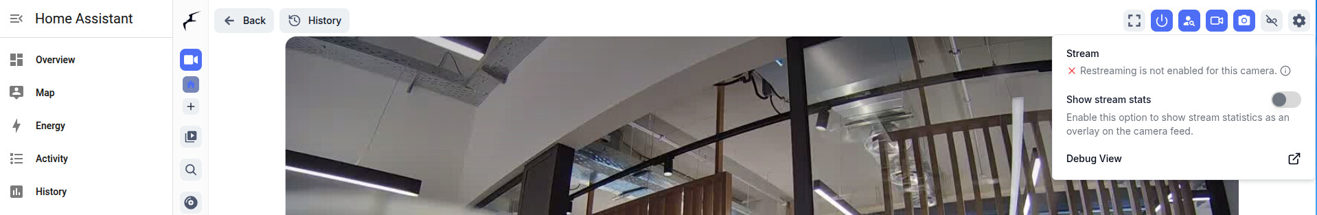

  1. If Frigate output errors about the Hailo model, you should try power cycling the Pi. Just restarting home assistant is not enough as the HAT is connected using PCIe and if driver is updated it need to update its FW.

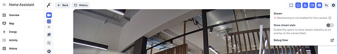

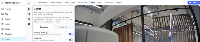

  1. Detections can be seen in real time (live) only via debug mode. Select the camera - and enter debug mode (via settings on the right).
  1. Allow bounding boxes - then inspect detection in real time.
  1. Detection bounding boxes can also be seen on recordings & snapshots: Navigate to “Explore”.
Select event, and then explore the Snapshot and the object life-cycle.

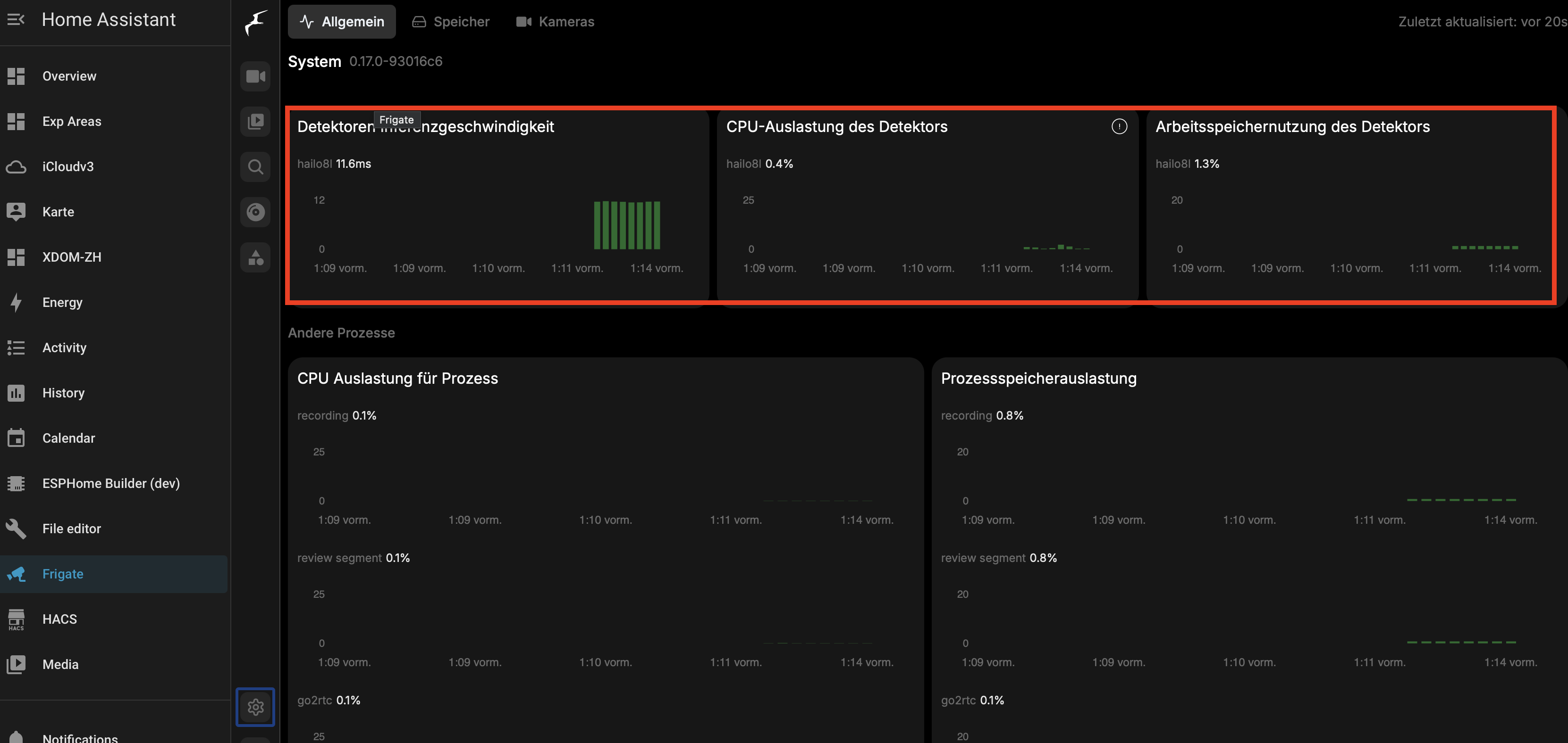

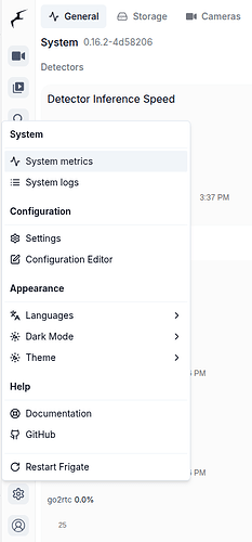

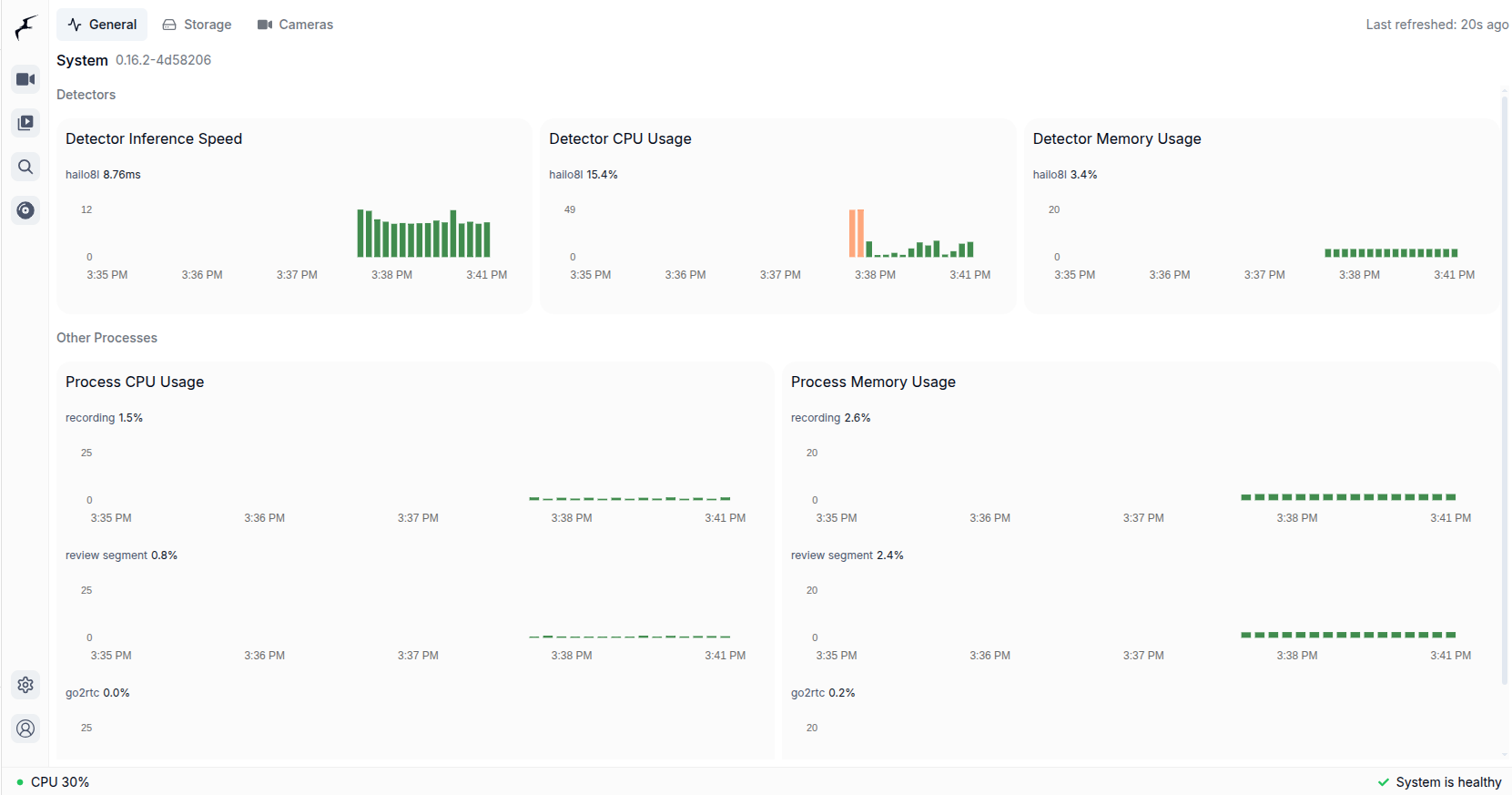

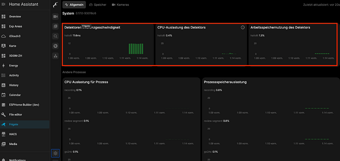

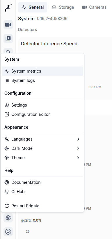

Explore the performance: Frigate → Settings → System metrics:
This is for a system with 4 cameras:

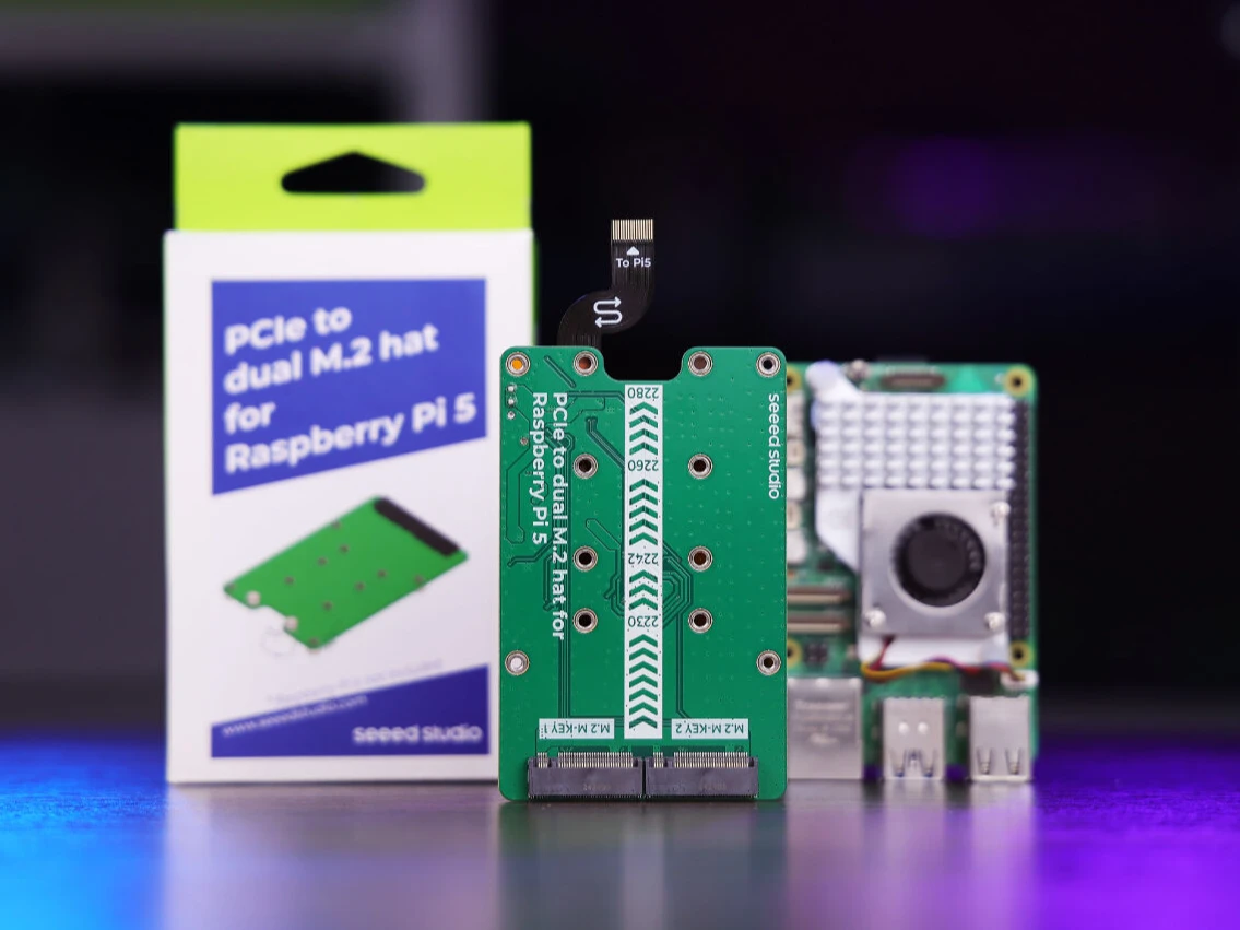

If I understand correctly, you’re using a Raspberry Pi 5 with PCIe Switch?
If that the case, then, maybe Raspberry Pi 5’s PCIe controller is running out of MSI interrupt vectors due to the PCIe switch?
If so, maybe adding pci=nomsi to your kernel boot parameters to use legacy interrupts instead, might be a solution.
  • Multiple PCIe devices through a switch (ASMedia ASM2806 in your case?)
  • The brcm-pcie controller has limited MSI interrupt vectors

I found the solution for my hardware :wink: — the problem was simply not reading the manual.
PCIe2.0 M.2 dual Hat supports PCIe Gen 2, and PCIe3.0 M.2 dual Hat supports PCIe Gen 2 and PCIe 3.
Step 1: Enter the following command to open the /boot/firmware/config.txt file
sudo nano /boot/firmware/config.txt
Step 2:Add the following to the [all] section at the end of the /boot/firmware/config.txt file:
dtparam=pciex1
dtparam=pciex1_gen=3
dtoverlay=pciex1-compat-pi5,no-mip,mmio-hi
The Hailo-8 accelerator is now working in Home Assistant OS on a Raspberry Pi 5 with the ASMedia ASM2806.
