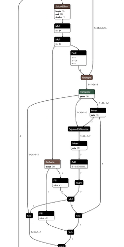

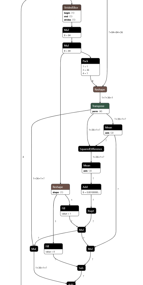

I’ve created a tflite file with layernorm, and it has decomposed it as can be seen in the image.
When I try to parse this, multiple ‘unsupported layer’ error pops up such as:
Mean operations that attempt to reduce the tensor across the batch, height, and width axes simultaneously (axis=[0, 1, 2]).
Unsupported SquaredDifference Operation
The parser fails on the specific Reshape and Transpose operations used within the LayerNormalization block, flagging them as an UnsupportedShuffleLayerError
I believe this indicates that the parser failed to identify the set of operations as a ‘layernorm block’.
