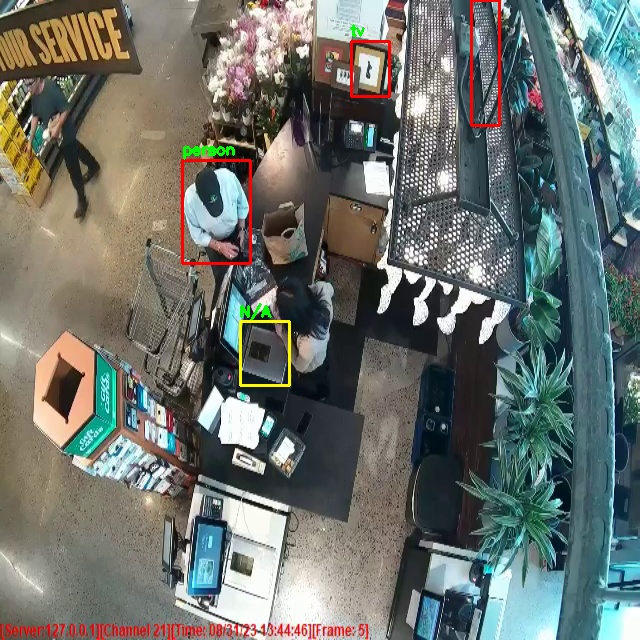

I’m using hailo8 to test yolov5m and yolov8 by the test sample. I could run the sample successfully and see the detected objects. But when I print and check the output stream, I found some issues that the buffer may not exactly follows the specification.
Here is one example:
hailo8 output stream is: ( I only print non-zero id and values)
[0]-1.000000, [1]-0.249405, [2]-0.284980, [3]-0.410521, [4]-0.390595, [5]-0.517700, [32]-1.000000, [33]-0.000507, [34]-0.736037, [35]-0.194623, [36]-0.779737, [37]-0.213832, [72]-1.000000, [73]-0.063949, [74]-0.548161, [75]-0.149549, [76]-0.607560, [77]-0.527487, [96]-1.000000, [97]-0.501904, [98]-0.374667, [99]-0.601512, [100]-0.451392, [101]-0.203154,
-I- Class [person] box [248] conf: 0.5177: (182.387, 159.619, 249.981, 262.733)
-I- Class [tie] box [248] conf: 0.213832: (471.064, 0.324396, 499.032, 124.558)
-I- Class [tv] box [248] conf: 0.527487: (350.823, 40.9271, 388.838, 95.7113)
-I- Class [N/A] box [248] conf: 0.203154: (239.787, 321.219, 288.891, 384.968)
As the function in the demo, it will only detect class idx <= 80, it will miss the last object information, which has class id 82. The correct class id should be 72 I think.
There issue doesn’t happen a lot in yolov8m and yolov5m, but it happens more frequently in yolov5s. Can you please help me to check and figure it out?
