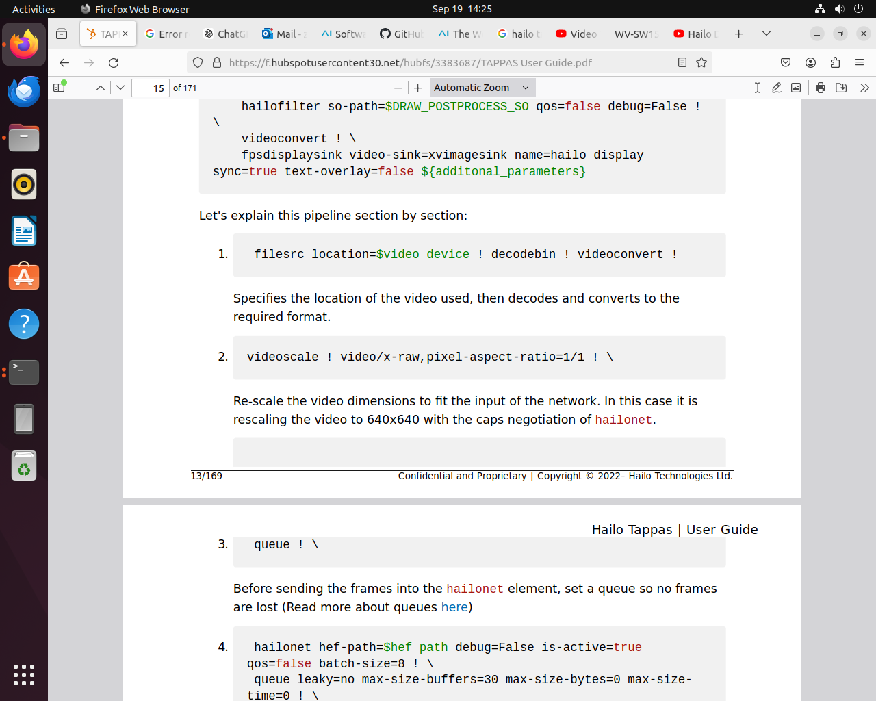

I connected an IP camera to my device, how do I perform detection on the live video footage of my camera?
According to the pipeline Step 1, I need to specify the location of the video being used, how do I find the location ? My camera is connected to my motherboard through ethernet interface.

To access your Ethernet-connected IP camera’s video stream, follow these steps:
  1. Locate the Camera’s IP Address
    • Check the camera’s web interface
    • Use the manufacturer’s software
    • Look at your router’s list of connected devices
  2. Configure the GStreamer Pipeline
    • Use the camera’s IP address in your pipeline
    • For RTSP streams, use this format:
      filesrc location=rtsp://<camera_ip_address>:<port>/path/to/stream ! decodebin ! videoconvert ! videoscale ! video/x-raw,pixel-aspect-ratio=1/1
    This setup decodes, converts, and scales the video for your TAPPAS pipeline.
  3. Optimize Camera Settings
    • Adjust video configuration as needed
    • Consider settings like bitrates and GOP length
    • Refer to your camera’s documentation for specifics
After completing these steps, proceed with the detection process outlined in the TAPPAS user guide.
