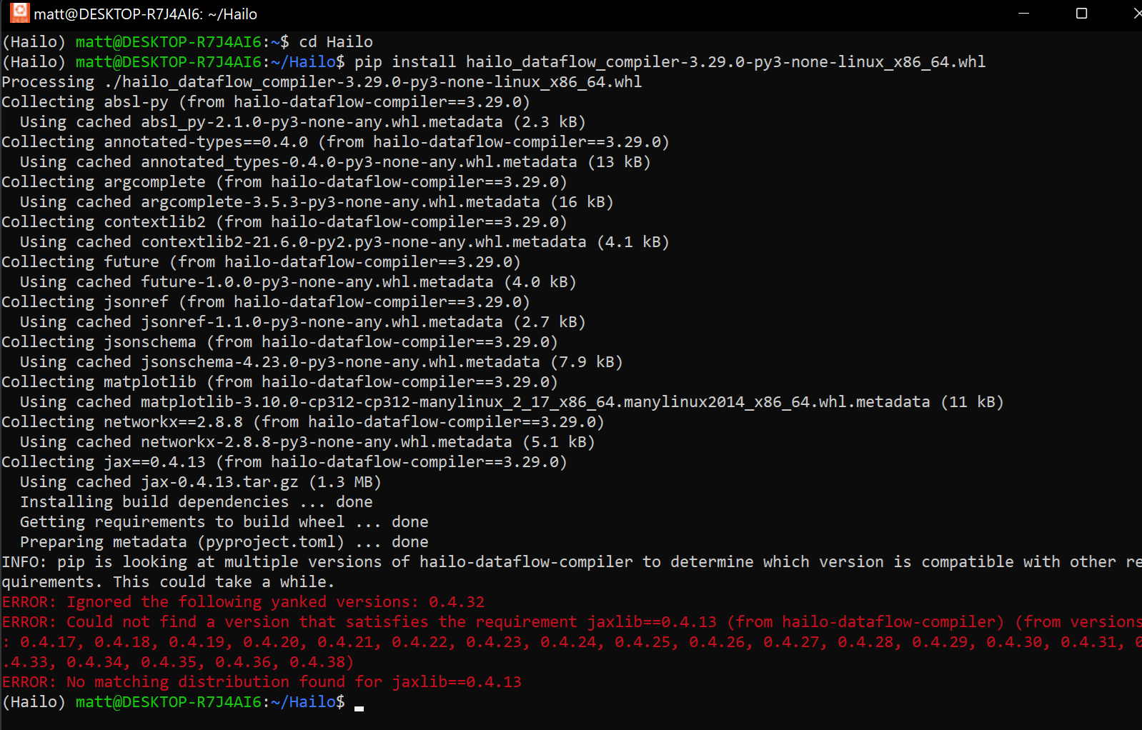

Hello, i’m trying to install the the DFC and I keep getting this error, concerning the jaxlib. I’m certain that it’s a me problem, but any help would be appreciated. Thanks

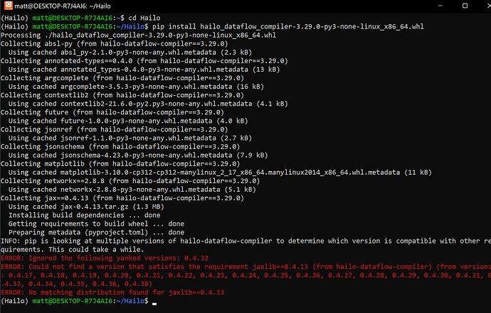

I tried to install jaxlib==0.4.13. but this version is not available
ERROR: Ignored the following yanked versions: 0.4.32
ERROR: Could not find a version that satisfies the requirement jaxlib==0.4.13 (from versions: 0.4.17, 0.4.18, 0.4.19, 0.4.20, 0.4.21, 0.4.22, 0.4.23, 0.4.24, 0.4.25, 0.4.26, 0.4.27, 0.4.28, 0.4.29, 0.4.30, 0.4.31, 0.4.33, 0.4.34, 0.4.35, 0.4.36, 0.4.38, 0.5.0, 0.5.1)
ERROR: No matching distribution found for jaxlib==0.4.13

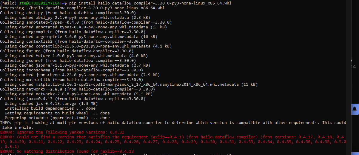

Hello, I’m having the same problem.
Trying to install DFC 3.30.0 in a fresh virtual env results in:
It seems version 0.4.13 of jaxlib is not available anymore, but it is required by DFC. Can I proceed somehow without needing you to bump the library inside the wheel file?
Thanks
I recommend using the Hailo AI Software Suite Docker. This avoids the dependency issues.
I did so and was able to proceed. Thanks.
