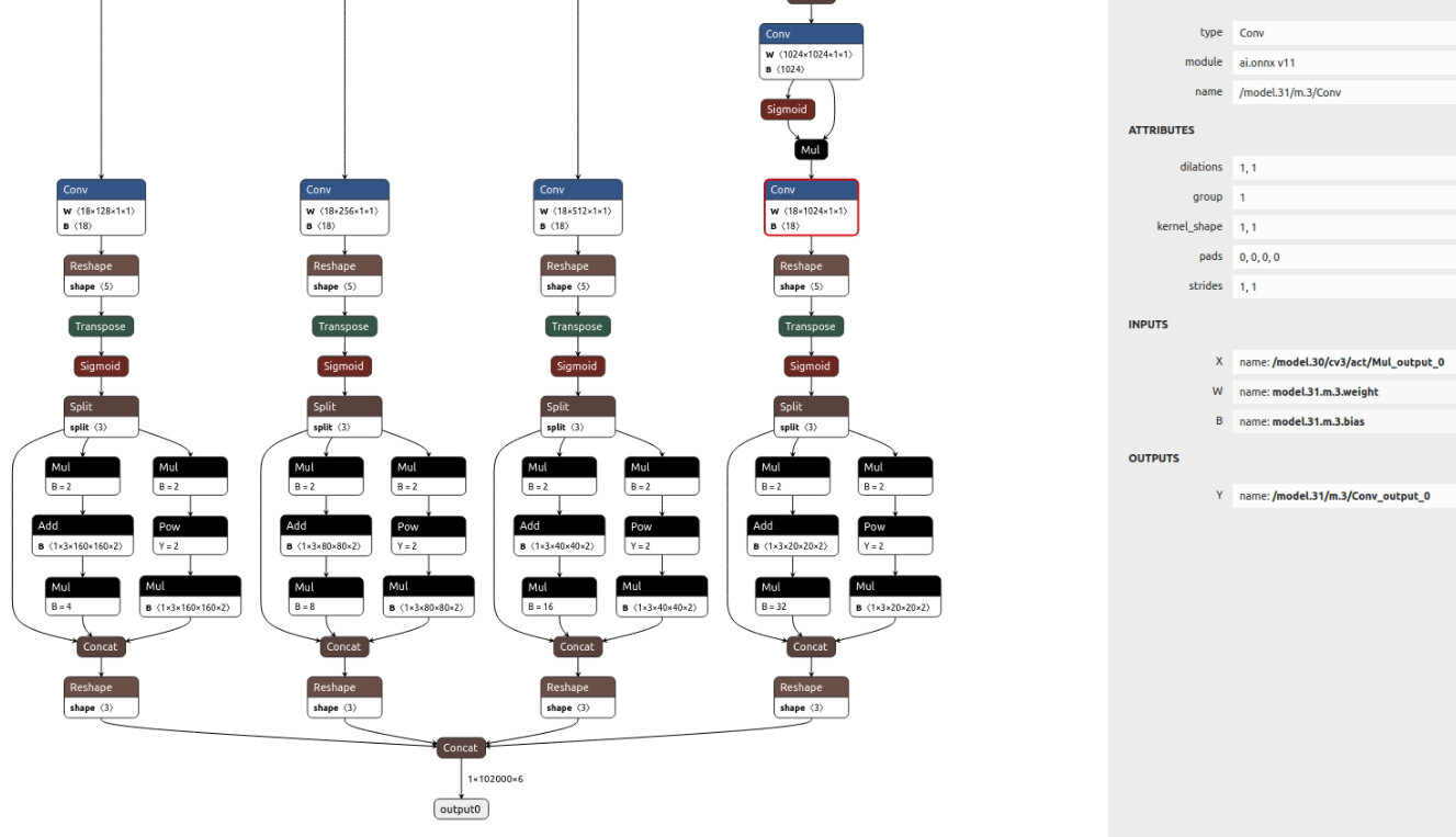

onnx output looks like so:
netron screenshot
I use that to obtain this code fro parsing:

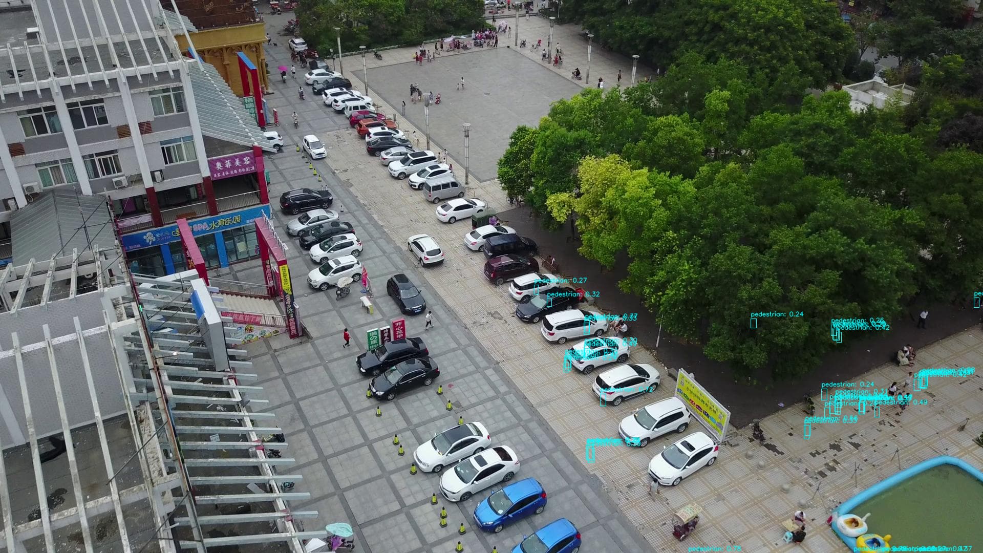

However when I run inference, even though I get some expected total detection counts, the detections are all wrong, getting mAP@50 = 0 :confused:
such as this image:
bad detections
Any ideas where I’m going wrong here?
