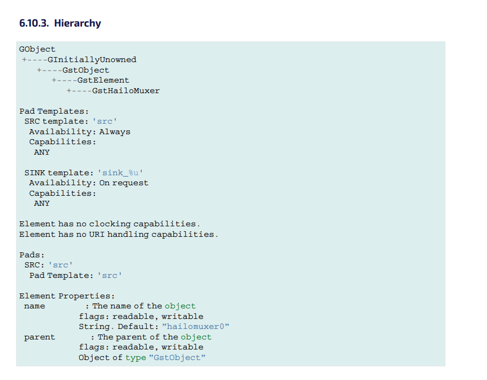

This is the hierarchy for the Hailomuxer:
Can you check if you have all the ancestors elemets installed?

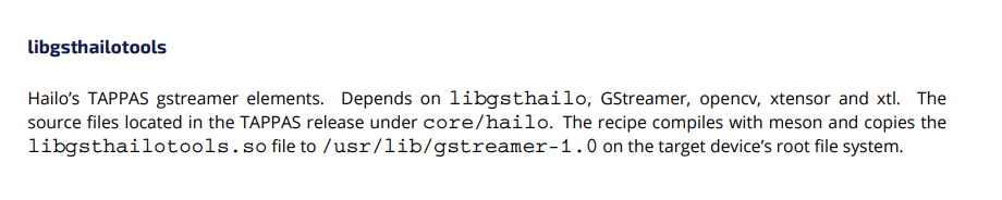

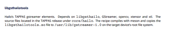

Hi @samjang9509,
These are the general instructions for the hailotools:
Also, in the git, you suppose to have the gsthailotools.cpp under core/hailo/plugins/ or, if you are not using x86 platform, you need to cross compile it using tools/cross_compiler/cross_compile_gsthailotools.py
