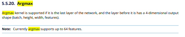

Ok, I understand. So we need the find a way to reduce the length of the Argmax. As you can see inthe user guide, the current implementation of Argmax supports up to 64 featurs.
Maybe theres’ a way to reduce that number after the ‘resnet50’ phase?
The main problem is that the compilation of argmax cannot convert its output to 16bit and so hailo crashes runtime because it cannot manage 5000 values with 8bit output. Read above. As soon as I can I will share with @nina-vilela the files.
For now thank you for your assistance
I understand now what you are sayng. You think that a part of the problem I wrote, argmax can manage only 64 values (features) and not the whole 5000?
Yes, this is the main caveat, our current implementation can handle up to 64 values and not the whole 5000.
