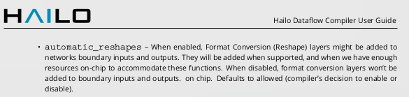

I compiled a HEF with automatic_reshapes disabled, so no on-chip Format Conversion (Reshape) layers are added at the network boundary.

  1. With automatic_reshapes disabled, does the DDR (NHCW) input reach the NN Core’s input boundary without any on-chip conversion?
  2. Is automatic_reshapes indeed the parameter that governs on-chip (NN Core) boundary conversion — as opposed to host-side conversion, which is handled separately by HailoRT’s format_order?

Yes, when you set this parameter to disable the Hailo Dataflow Compiler will not add the reshape.
If the VStream format is NHWC, the data will be reordered ether by HailoRT or the device. This depends on whether the Hailo Dataflow Compiler can add the reshape on device without affecting the FPS.
