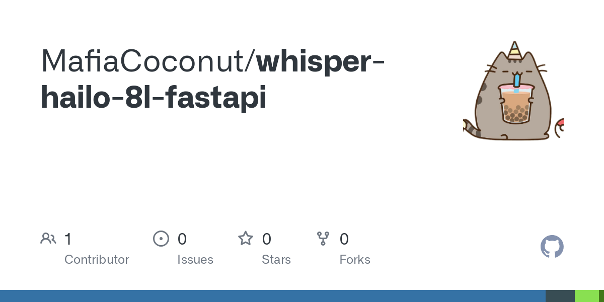

I’d like to share my modification of the speech_recognition project from Hailo-Application-Code-Examples.
With this update, you can easily deploy a Docker container on your Raspberry Pi 5 that accepts audio files via an API and returns transcribed text as a response.
I started this project to integrate speech recognition into my smart home system and a custom Telegram chat bot. I’m planning to add new features and improvements soon—so stay tuned!
As of June 26, this is the first working version.
Tested on Ubuntu Server 25.04, Hailo-8L, HailoRT v4.21, Python 3.11.9.
Docker container works on Ubuntu 24.04, Python 3.11.9.
I’d be happy to hear your questions, suggestions, and feedback!
