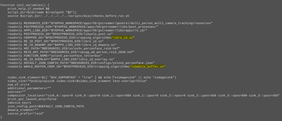

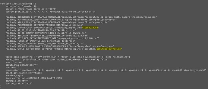

Hi, there! The program needs the libre_id.so and libwhole_buffer.so, and I wonder where I can get these files. Thanks! ![]()
Hey @js12459743 ,
You can find these in here : tappas/core/hailo/libs at master ยท hailo-ai/tappas ยท GitHub
Thanks for replying. I wonder if I can only compile to the libre_id.so through x86 architecture. Can arm architecture do it?
Yes , just make sure you run the correct option in the cross compilation.
if you need help with this feel free to ask !
