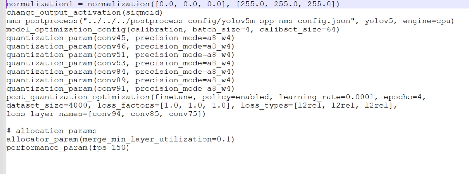

Thanks, actually we use the default one.

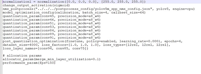

I think there has no corruption issue .
I have not change the file after I install the package. Below link is the file
