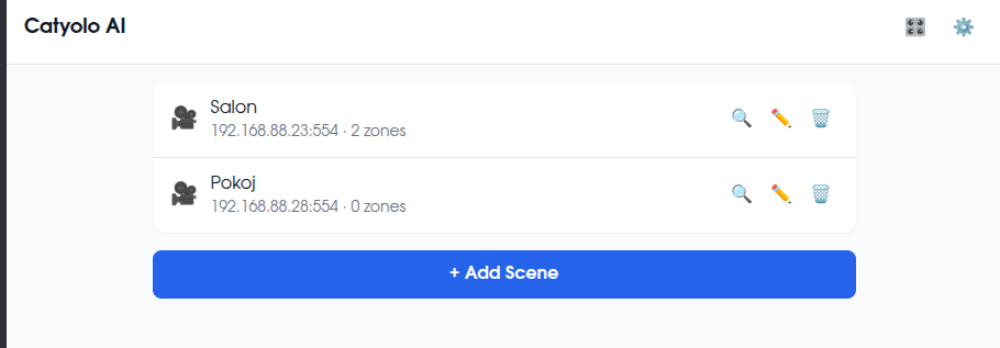

It’s similar to Frigate - it allows you to connect multiple RSTP camera feeds, grab a frame and draw ‘forbidden zones’ on it. Then you can select classes for object detection and define actions triggered by object detection.

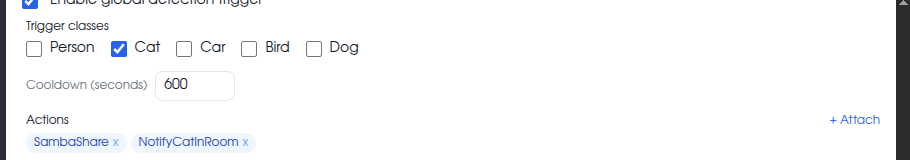

Eventually for Hailo10H users there is also optional VLM gate - you can write your custom prompt that will run on succesful detection (e.g. Is the cat attacking the plant?, but i can also imagine something like ‘is this person wearing a helmet’) - and if it’s enabled then the alert will be triggered only if the VLM outputs ‘Yes’

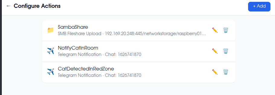

Among configurable alerts you have an SMB File upload, Telegram notification and custom webhook - so that you can wire it to any kind of automation you would like.

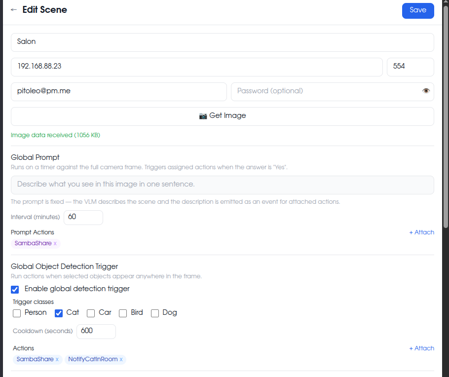

screenshots:
Adding scenes (I tested on 2 cameras at the same time. Capped at 15FPS and it works okay)
