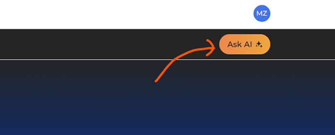

Very good question, before I go to the answer, I want to highlight the ability to get immediately through our AI assistant on the Deverloper-Zone:
I’ve just pasted your full question there to get the immediate answer-
Using ollama run ... against hailo-ollama is not expected to work, even if you set OLLAMA_HOST, because the Hailo server only implements the REST side, not the full Ollama CLI protocol. This is something that is on our working plans.
