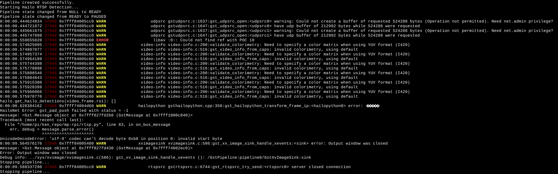

UnicodeDecodeError when using hailopython
I am trying to use hailopython to retrieve detection data from my custom hef model. The postprocess.py will run once and then the stream will throw the UnicodeDecodeError.
However, if I use hailofilter and the built-in postprocess .so files, the script works perfectly fine.
I have quite limited knowledge on hailo and gstreamer, so any help is appreciated.
Here is my rtsp.py:

postprocess.py:
import hailo
from gsthailo import VideoFrame
from gi.repository import Gst
def run(video_frame: VideoFrame):
    print(f'hailo.get_hailo_detections(video_frame.roi): {hailo.get_hailo_detections(video_frame.roi)}')
Output of rtsp.py with GST_DEBUG=2:
