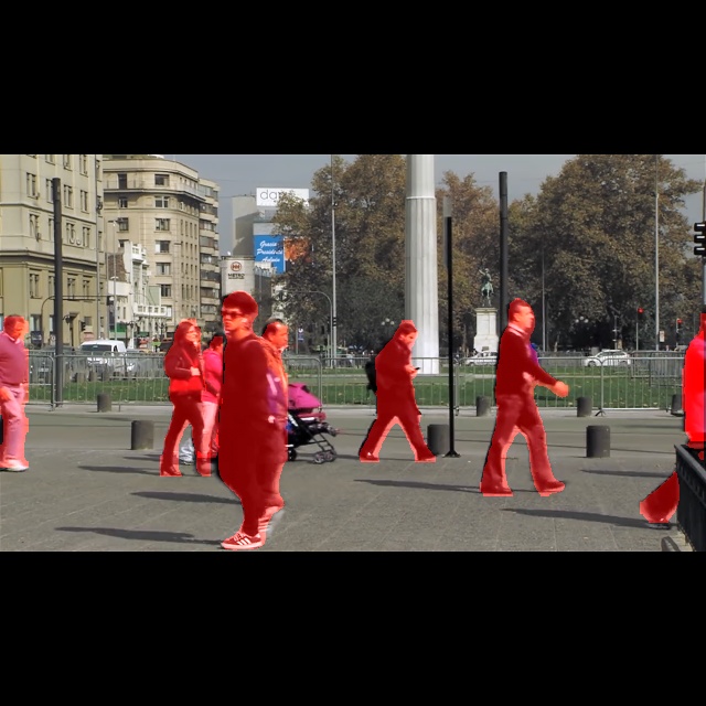

I made a small edit to the example code to output a few frames for review:
Before edit to instance_segmentation_pipeline.py:
After edit to line 171 of instance_segmentation_pipeline.py:

(note, the lack of different colors is due to all detection’s having the same id due to the removed tracking)
In some frames the mask looks like it was held from a prior frame. In others the mask doesn’t fit any surrounding frame.

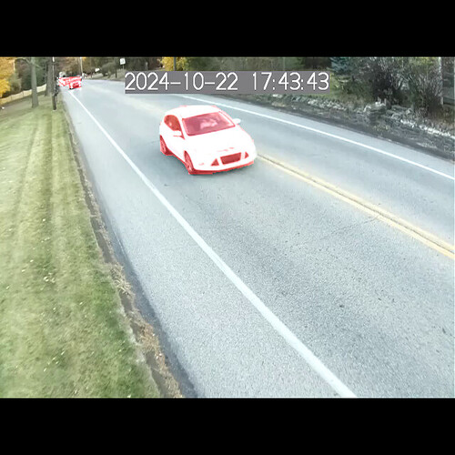

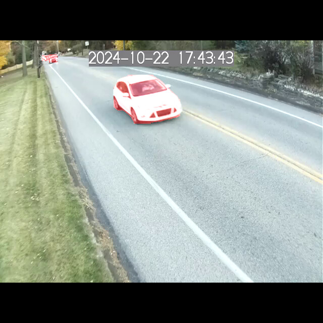

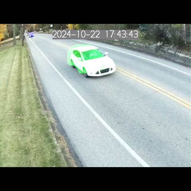

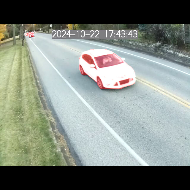

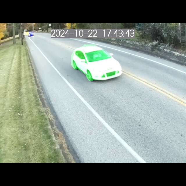

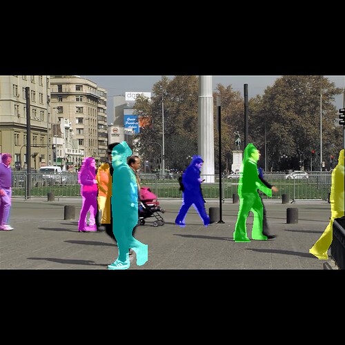

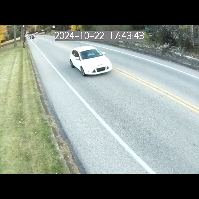

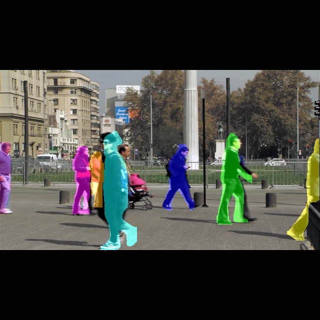

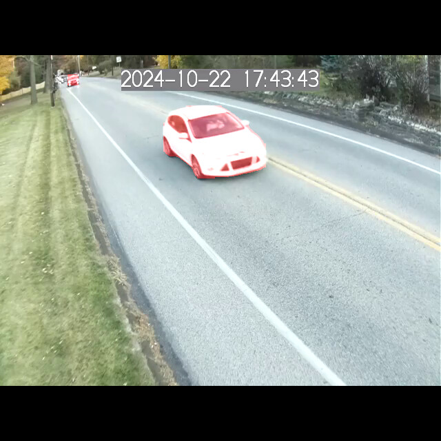

I am not sure that my issue is stale masks due to a detection miss. The following images show it a bit clearer. The masks do not align with any of the prior frames, but if I remove tracking the masks align nicely. This is most noticeable by looking at the detection of the front tire on frames 3 and 4.
If the Kalman filter is passing the masks unchanged, then I would expect the detection to match either the current frame or a previous frame. That is not what I see. Is it possible that the sample code is grabbing the predicted state of the Kalman filter instead of the unchanged mask?
First 4 frames of a sample video with tracking enabled:
Frames processed with tracking removed:
