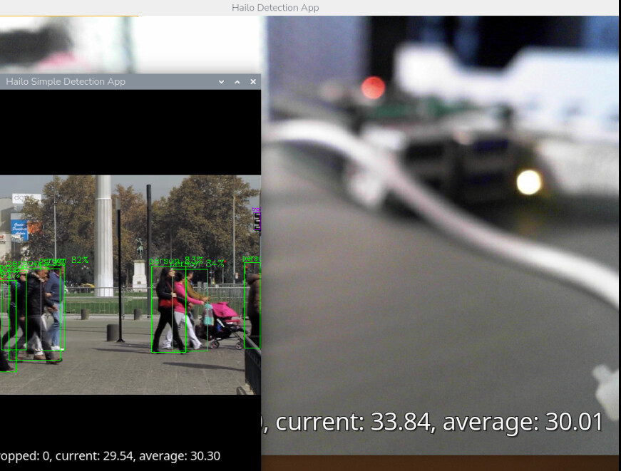

Hi @marco ,
Below is from Pi with 8L detection (Yolo8m) and detection simple (Yolo6n) both running in parallel and FPS above > 30.
Can you please confirm if running in parallel from our new hailo-apps repo + following the running parallel guide there, resulting in your case low FPS?
