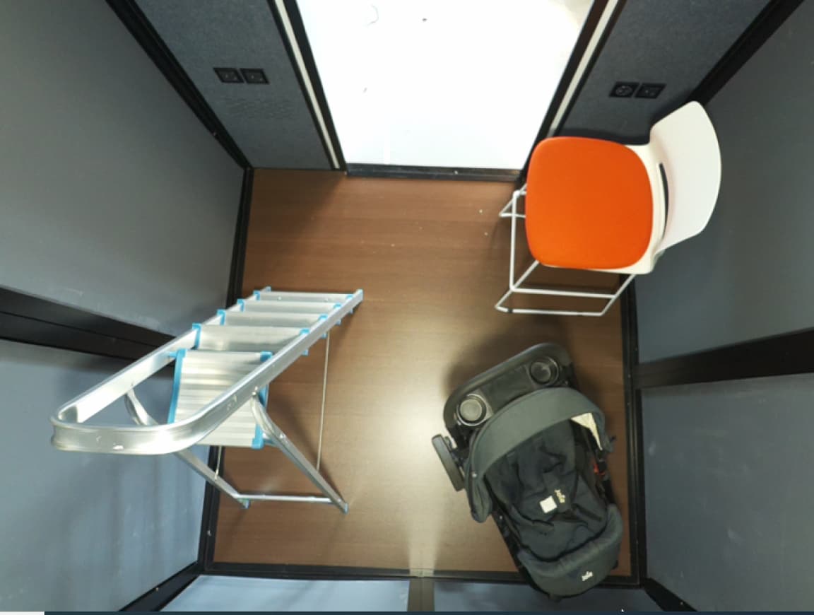

What would be the right approach to measure the space occupied by objects in a lift car? We can have an initial calibration where the camera sees an empty car, so the floor can be detected and measured. Then objects / people can enter the car and we want to measure the space occupied by them. Any suggestions?

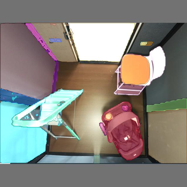

Maybe segmentation could work for that. The inference results below are from our instance segmentation Python example using fast_sam:
You can use the detections’ masks to count the space they occupy in the floor area of the image.
There will also have to be some extra work to calculate some missing pixels - like the ones under the ladder.
You could also use the bounding boxes from object detection if you don’t mind not being too accurate in the area. But for that, you would need to find/train a model with the same ceiling angle as in the elevator.
Hope this helps and good luck with your project!

I was thinking of just counting the pixels of the detection masks, but how to address the case of a tall object (like a person) who is near the walls? Just counting the pixels of the mask will be too high because we see the fully body.
The only difference for the rpi5 is that you will need the hef compiled for Hailo8-L
You could focus only on the area of the floor to address this. By identifying the coordinates (xmin, ymin, xmax, ymax) that correspond to the floor, you can then count only the pixels within this specific region.
