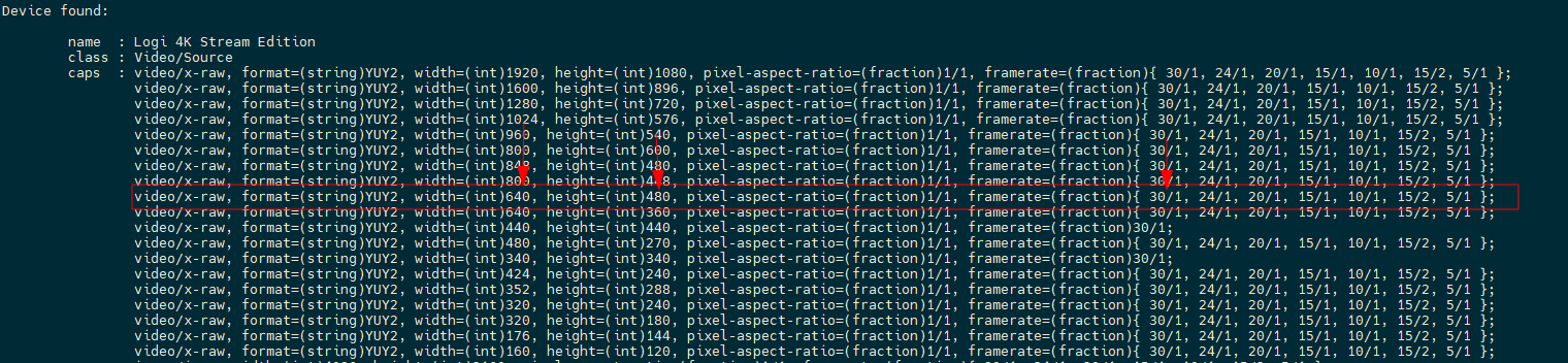

Can you check if your camera is capable of outputing VGA (640x480) @30FPS?
You can check that with this command:
gst-device-monitor-1.0
It would give a long output, listing all the available resolutions for each connected camera, but ideally you would see something like that:
It lists raw video at 640 by 480 but it doesn’t specify anything else
video/x-raw, format=YUY2, width=640, height=480
