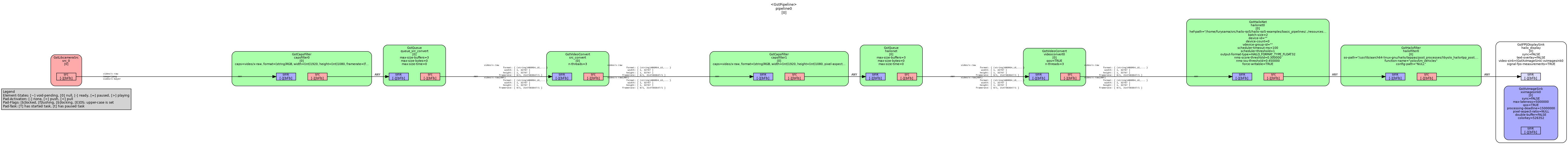

Huge! Thanks for the pointer. I have been fiddling around with my pipeline to no avail as of yet, though this is what i come up with:
From what I can tell, data is getting to the hailonet, but it might not be in the right format. I’m not sure how to format it correctly - i tried to use a capfilter to ensure everything was the right shape, but maybe i need a separate convert step for the hef:
Architecture HEF was compiled for: HAILO8L Network group name: yolov5m_vehicles, Multi Context - Number of contexts: 6 Network name: yolov5m_vehicles/yolov5m_vehicles VStream infos: Input yolov5m_vehicles/input_layer1 UINT8, F8CR(1080x1920x3)

Regarding the gstreamer pipeline, You are using a jpeg/mjpeg input. This has to be decoded before you can use it for inference. Add a decodebin element to handle it. In addition you might need to rescale the frame to fit Hailo’s input. you can use videoscale for this.
