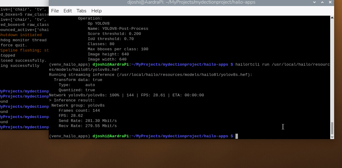

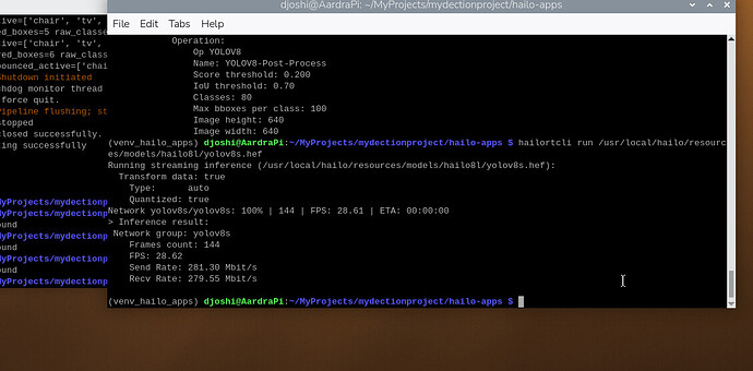

Hi Michael
Thank you for the confirmation. So with Hailortcli, we can test how fast the model performs. It seems that yolov8s.hef is producing about 30fps as well.
