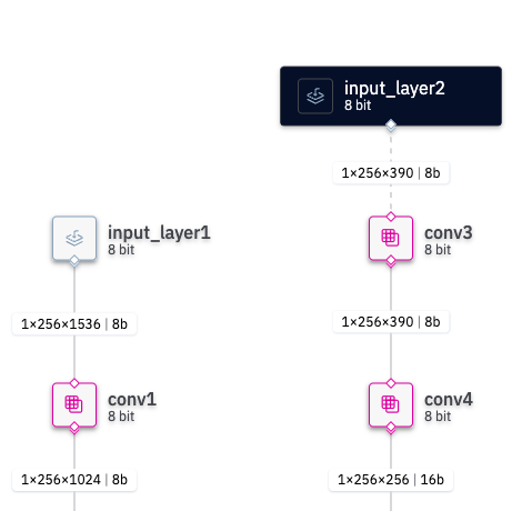

Specifically, I have ONNX models whose inputs are rank-3 tensors with shape (Batch, Tokens, Channels) (e.g. (4, 256, 1536)), representing precomputed features rather than images.

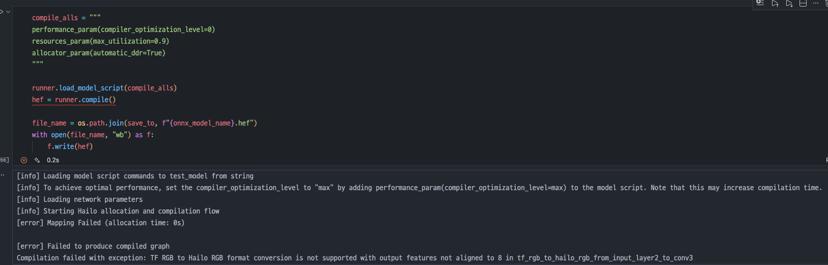

- Prevent the compiler from treating these inputs as image/RGB inputs
- Disable any automatic RGB or image-related preprocessing (e.g. TF RGB → Hailo RGB conversion)

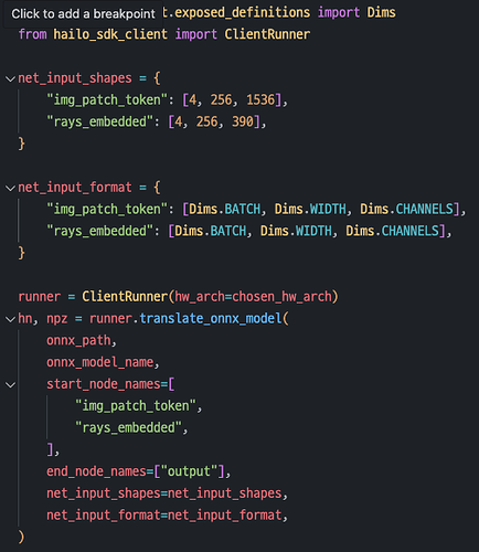

Should net_input_format with [Dims.BATCH, Dims.WIDTH, Dims.CHANNELS] be sufficient?
