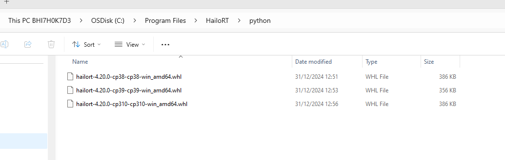

when downloading version 4.20 of the Hailort driver and installing the python packages. when one navigates to the correct folder in program files. there is no wheel file for python 3.11 in there. see screenshot attached.

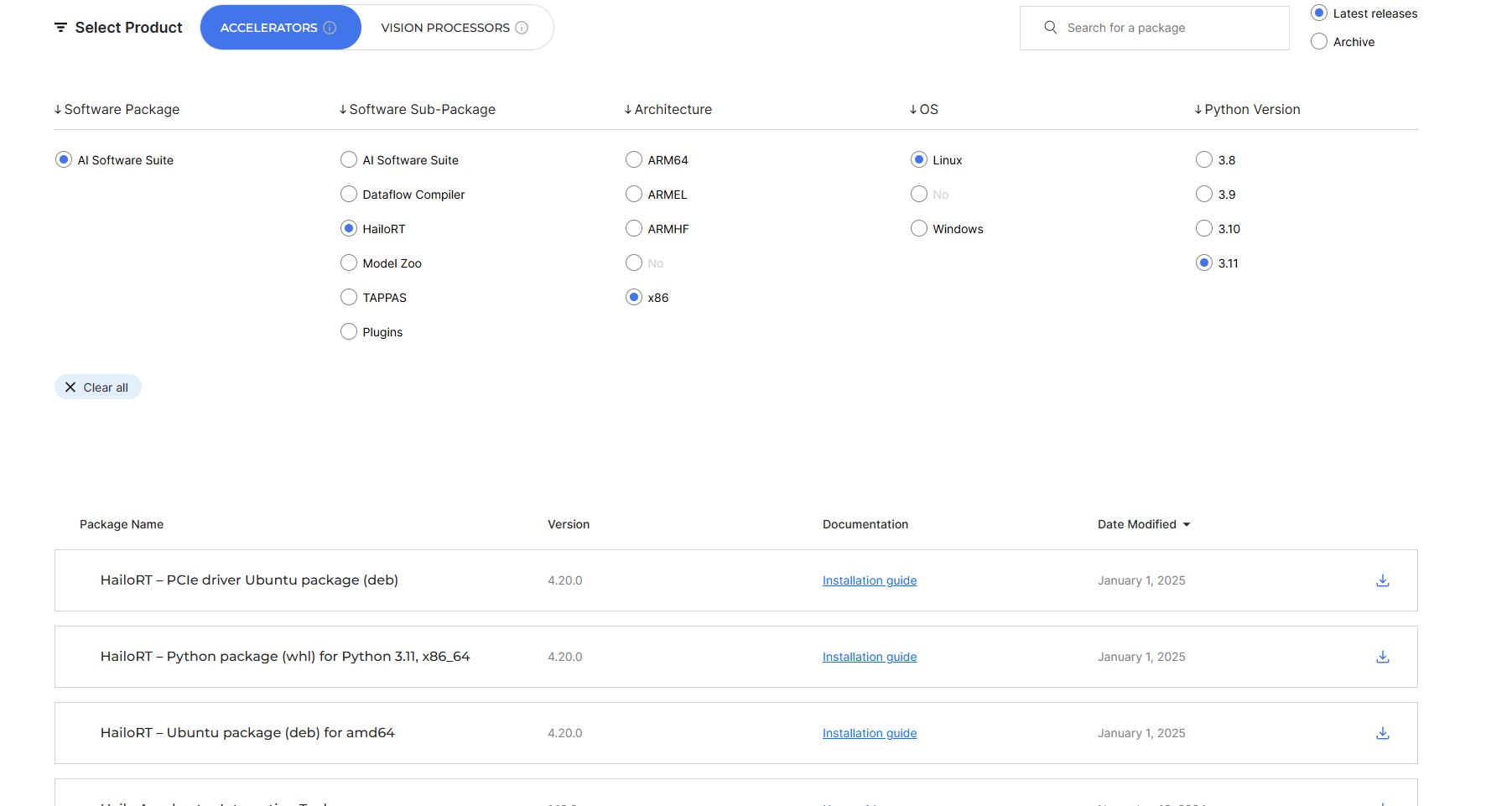

Hey @nitish.jha ,
In the site https://hailo.ai/developer-zone/software-downloads/ , pick these options and you will see the 3.11 version to downlaod.
hi @omria the website is wrong.
in version 4.20 (latest version) for windows there is no wheel package for python 3.11 as shown by my previous screenshot.
Hey @nitish.jha ,
I re checked and you are correct.
We are going to update this in the site ( we don’t have python 3.11 for windows for now )
