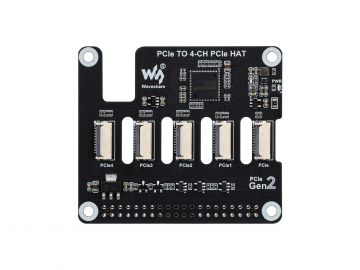

Yes you can
Look :
But only gen 2…

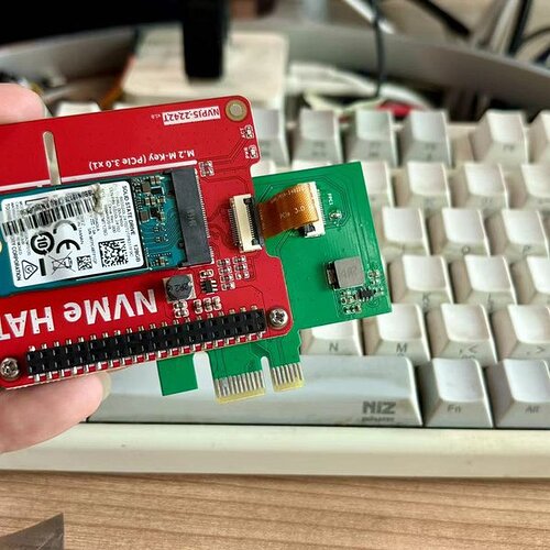

It may be possible to use the Open-HAT-PCIe
if you want to attach a Pi AI HAT to a PCIe slot on a PC motherboard. You would need to also run +5V and Ground to the AI HAT, maybe from a SATA power cable in the PC.
I ordered five of the Open HAT PCIe boards from PCBWay, I should have them in 3 or 4 days. I paid about $75 for the 5. I don’t know for certain that this will work, but confidence is high.

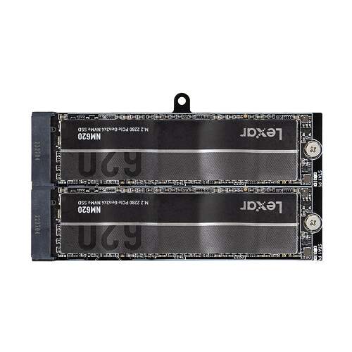

Je pense que Thomas_Hepworth utilise comme moi un boîtier pironman 5 et veux utiliser un double nvme
Mais au.lieu de.mettre un ssd et module AI en M2 il veux mettre un ssd et utiliser sa carte AI HAT 13 TOPS ou AI HAT + 26Tops ou AI HAT +2 40Tops en externe avec une connexion sur le second port M2 un peu ce genre lĂ  :slight_smile:
