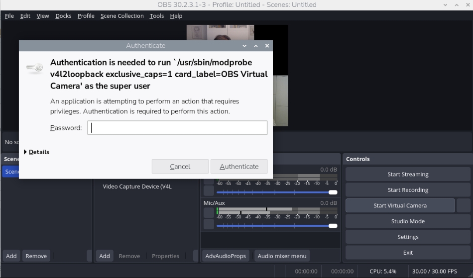

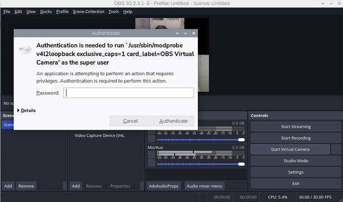

For completeness about the Virtual Camera in OBS on the RPi 5:
Install OBS from Pi-Apps (https://pi-apps.io/) in the Multimedia category.
By default OBS does not show the Virtual Camera button, so v4l2loopback needs to be installed with sudo apt install v4l2loopback-dkms. After rebooting the RPi, OBS shows the Virtual Camera button. (Source: OBS Studio Install Instructions at Install Instructions · obsproject/obs-studio Wiki · GitHub).
Gabor
… the documentation of v4l2loopback here may help (also pasted below). I’m not confident with modprobe. Could someone help please?
Gabor
If you encounter problems detecting your device with Chrome/WebRTC you can try ‘exclusive_caps’ mode:
# modprobe v4l2loopback exclusive_caps=1
This will enable ‘exclusive_caps’ mode that only reports CAPTURE/OUTPUT capabilities exclusively. The newly created device will announce OUTPUT capabilities only (so ordinary webcam applications (including Chrome) won’t see it). As soon as you have attached a producer to the device, it will start announcing CAPTURE capabilities only (so applications that refuse to open devices that have other capabilities apart from capturing can open it too.)
CHANGING OPTIONS
Options that you provided when loading the module (e.g. via modprobe) cannot be easily changed on the fly. In order to change these options, you must first unload the module with rmmod (which will only work if no application is any longer accessing one of the loopback devices) and then load it again (with the new options).
I couldn’t resist it, so I tried sudo modprobe v4l2loopback exclusive_caps=1 but I get the same error message.
Now when I click Start Virtual Camera in OBS, I get a prompt for the password and this suggests that the exclusive_caps=1 parameter is set by OBS anyway.
I then tried sudo modprobe v4l2loopback exclusive_caps=0but it doesn’t make any difference…
