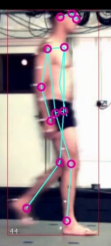

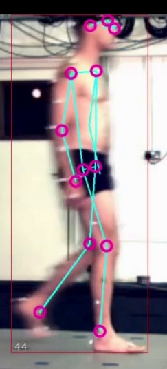

pose estimation keypoints with and without ring
Pose estimation shows lines connecting some pairs of the 17 keypoints to draw a human stick figure and then rings are drawn on some of the keypoints. It seems that the keypoints identified with higher confidence get a ring, the ones with lower confidence don’t get a ring e.g. when the body part is obstructed or is on the other side of the body.
How can I access if a ring is drawn (true/false) or the confidence level of each keypoint in app_callback() of pose_estimation.py? This is to find frames where the confidence is too low to continue processing the coordinates.

“It seems that the keypoints identified with higher confidence get a ring, the ones with lower confidence don’t get a ring”: The demo app draws the same circle for all landmarks. There is no per landmark confidence’s drawing logic.
Hi @Michael,
When I use my webcam with pose estimation and turn my head, the hidden ear has no ring/circle… but I didn’t want to show my face here.
Below the guy’s left arm is hidden and the left elbow and wrist are drawn with lines but without the rings/circles.
