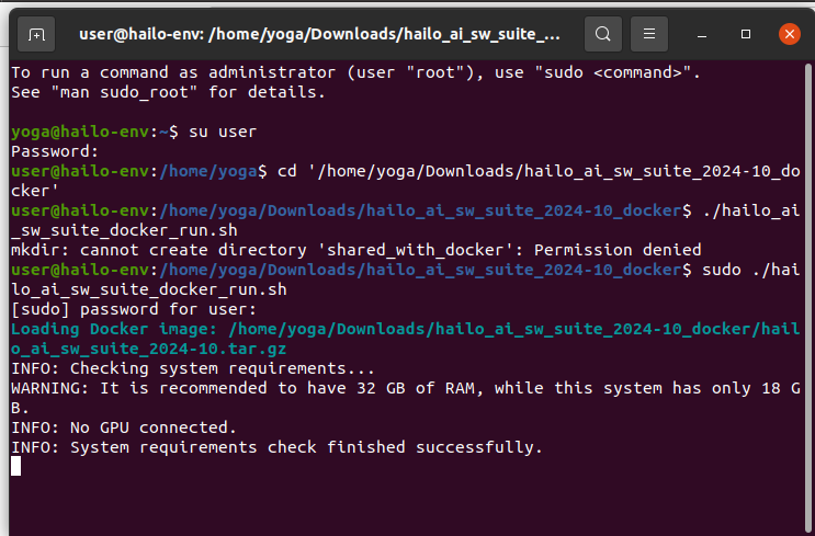

thanks for the response. I have tried to install the docker on my virtual box ubuntu 20 environment. I started off with 8gb RAM but I got the error that I need 16gb space. I reconfigured everything to 18gb ram now I am getting the error I need 32 gb ram. Attatching the ss :
I would really appreciate some help in understanding the min system requirements for this. and after installation any guide towards building my own .hef file.

We do not validate our software in virtual machines and therefore do not support this. It may work or not.
This is just a warning. You can ignore it.
The Hailo AI SW Suite User guide states 16+ GB minimum (32+ GB recommended). The more the better.
