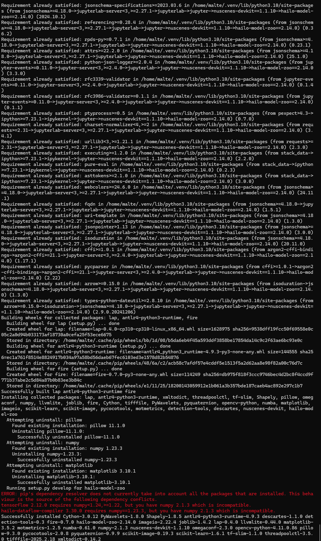

DEPRECATION: Legacy editable install of hailo-model-zoo==2.14.0 from file:///home/ben_tid/compile/hailo_model_zoo (setup.py develop) is deprecated. pip 25.0 will enforce this behaviour change. A possible replacement is to add a pyproject.toml or enable --use-pep517, and use setuptools >= 64. If the resulting installation is not behaving as expected, try using --config-settings editable_mode=compat. Please consult the setuptools documentation for more information. Discussion can be found at Deprecate `pip install --editable` calling `setup.py develop` · Issue #11457 · pypa/pip · GitHub
Running setup.py develop for hailo-model-zoo

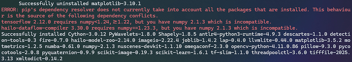

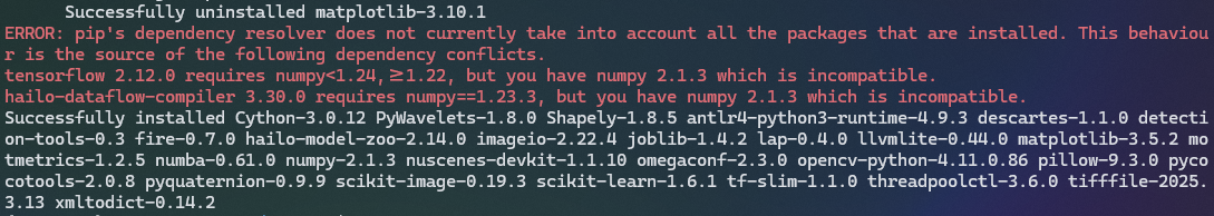

ERROR: pip’s dependency resolver does not currently take into account all the packages that are installed. This behaviour is the source of the following dependency conflicts.
hailo-dataflow-compiler 3.30.0 requires numpy==1.23.3, but you have numpy 2.1.3 which is incompatible.
hailort 4.20.0 requires numpy<2, but you have numpy 2.1.3 which is incompatible.
tensorflow 2.12.0 requires numpy<1.24,>=1.22, but you have numpy 2.1.3 which is incompatible.
