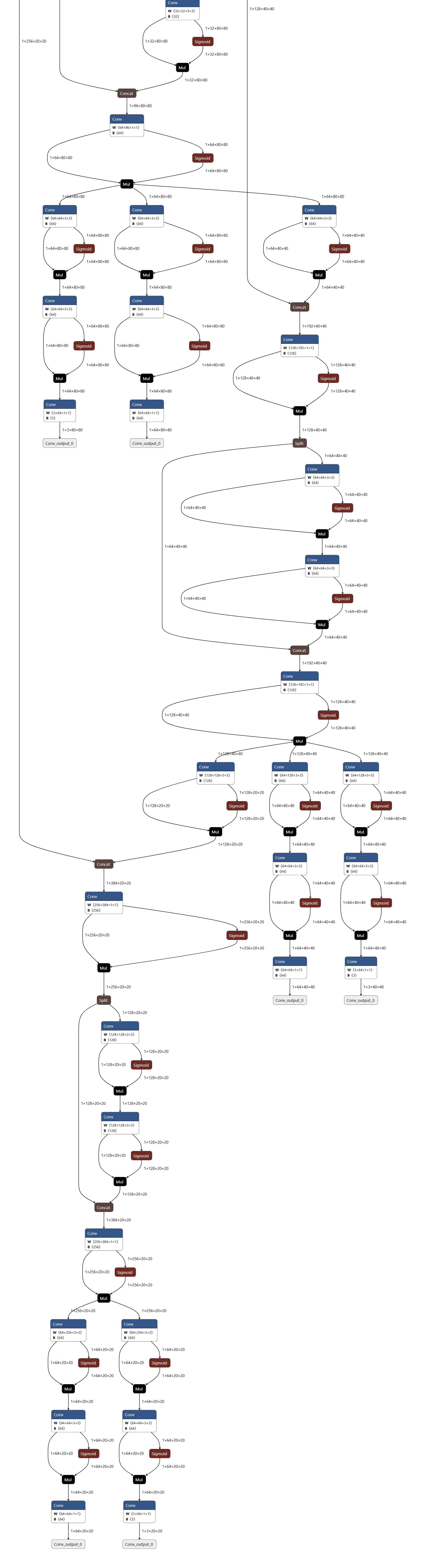

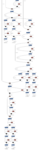

thank you for help, Last try - onnx cutted, everything go well, but now it wont work on rpi (something with structure nodes error)
I used commands:
(hailo_virtualenv) hailo@093c81a230e2:/workspace$ hailo optimize best.har --calib-set-path calibration_npy --hw-arch
hailo8l
(hailo_virtualenv) hailo@093c81a230e2:/workspace$ hailo compiler best_optimized.har --hw-arch hailo8l --model-script
yolov8_nms.alls
(hailo_virtualenv) hailo@093c81a230e2:/workspace$ hailo parser onnx best.onnx --hw-arch hailo8l --start-node-names image
s
here is cutted onnx graph looks like:
I m soending on this last week without working model :confused:
