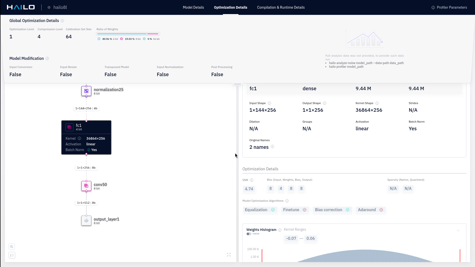

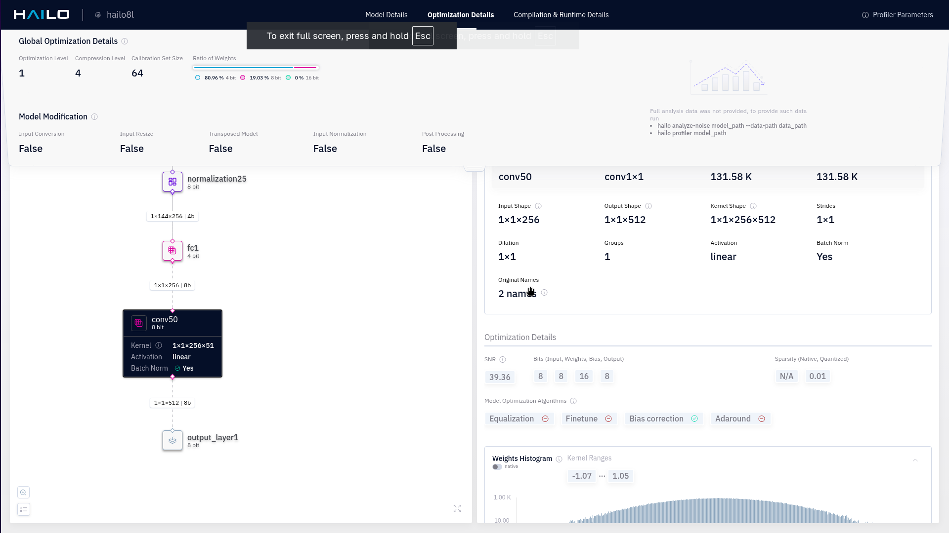

Hey @gyom,
The "No format for fc1 -> conv50" error means the compiler can’t find a valid hardware layout for the tensor between these two layers, causing compilation to fail immediately.
Here’s what to try:
  1. Check your layer shapes - Use the Optimization Report to verify fc1 output and conv50 input match properly. Make sure there’s no hidden reshape/flatten between them that could cause layout issues.
  2. Remove manual compiler settings - Strip out any custom resources_param or allocator_param tweaks and use automatic settings only. Sometimes manual constraints conflict with the compiler’s optimization flow.
  3. Adjust layer precision - Your fc1 is running at 4-bit with low SNR (~4.7 dB) while conv50 is 8-bit. Try forcing fc1 to 8-bit:
   layer_precision(fc1, precision_mode=A8_W8)
  1. Simplify the model - Since fc1 → conv50 with 1×1 shapes are equivalent to a single 1×1 conv, consider merging them in your original model, then re-export and recompile.
If none of this works , can you provide the alls file!
