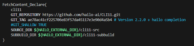

For the time being, this will be a good w/a to get you moving. In the build directory change the following file:
./tmp/work/armv8a-poky-linux/libhailort/4.23.0/git/hailort/cmake/external/cli11.cmake
comment out the line GIT_SHALLOW TRUE
Please let me know how it goes!
