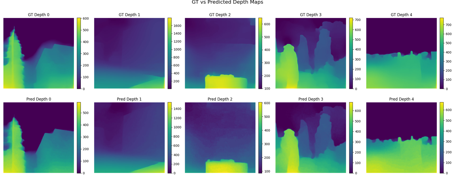

Here’s a comparison of the output: FP32 ONNX (upper) vs INT8 quantized (below).
HEF file size is about 20MB

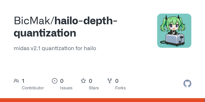

Ok. I share the Hef file of Midas
