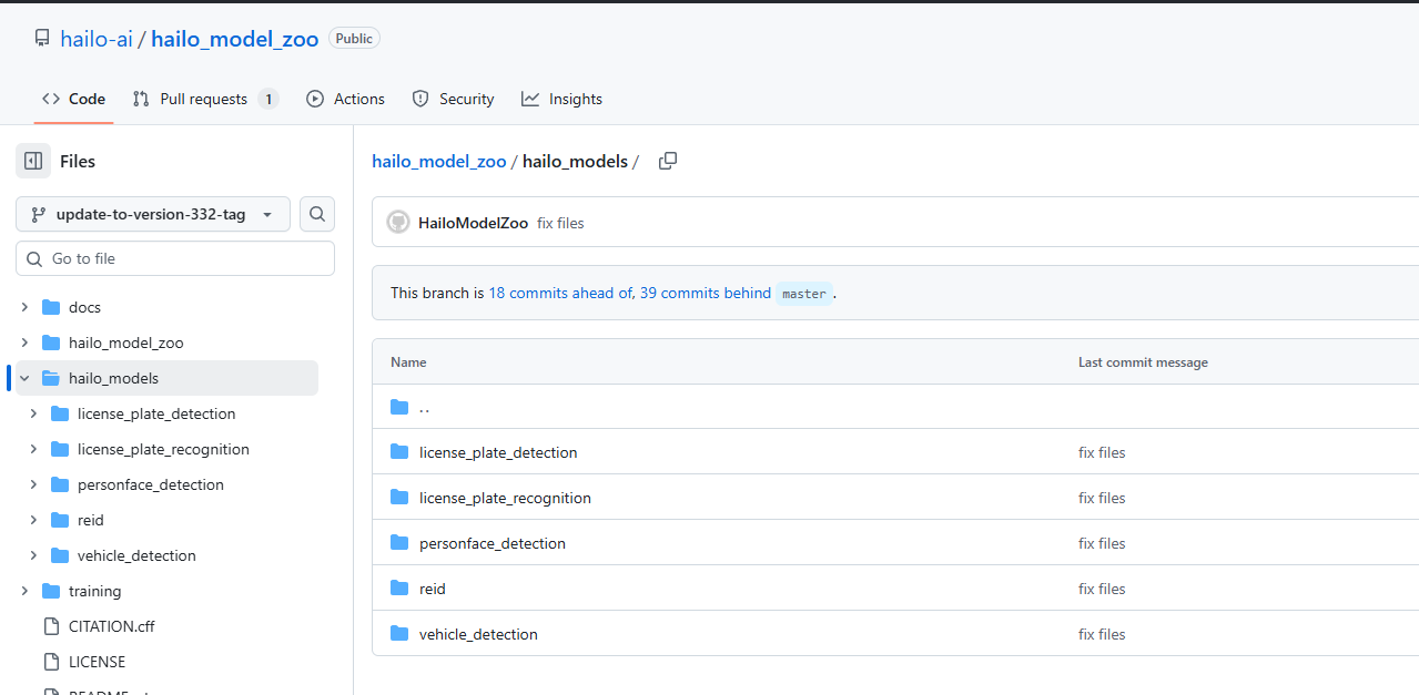

I’m looking for some guidance on how to get started with Hailo License Plate Recognition (LPR) in Rpi5 with Hailo8L. I’ve already gone through some documentation related to it and also tried doing my own research, but I am kind a block and unsure where to start.. My goal is to use and combine below existing models found in the Model Zoo.
I have successfully cloned and installed the Model Zoo on my desktop machine. Could someone guide me please on how can I put these models together so that I can run a full LPR, test, and then transfer it to my raspberrypi5 with Hailo8L. Any advice would be truly appreciated.
